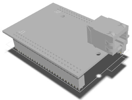

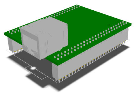

I have them as 2 schematic parts that I can put on any sheet. This makes it easier to put all the memory mapped stuff on a different sheet and the IO on another. Makes it a lot less cluttered and means I can use A4 sheets instead of A3. But then, the software I have allows you to do this and not being familiar with Eagle not sure if you can do this but well worth the effort to find out.Ridgeglider wrote:With one footprint, all this stuff moves as a unit. All this helps with the mechanical layout, but makes the schematic somewhat of a pain since often symbols for J1 and J2 want to wind up on different pages....
The PCB part is one part complete with a 3D model of the MOD5234 (and 5270). This avoids the issue of alignment and positioning of the connectors.

Love the 3D, do you have these in step? Please post.
