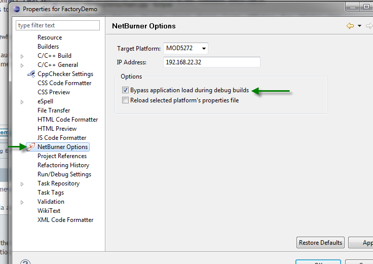

Yes. See the attached image. With this set when you re-run your debug configuration it just prompts you to quit the current session and starts over.

This sort of works but doesn't restart the code from the beginning. It just seems to reconnect the debugger, which for some stuff will work for me. Ideally I want a restart of the app without the reload.
I also don't see a way to load any updated code with this option selected. I have made changes and then rebuilt the code but not I can't see how to download this without switching this option off!!

At first I thought you was joking, then I realised that with the suggestion from Tod this would work and sure enough it does!!
Just need a way to download recompiled code without changing the check box option and I am in business but otherwise this is excellent suggestions.
