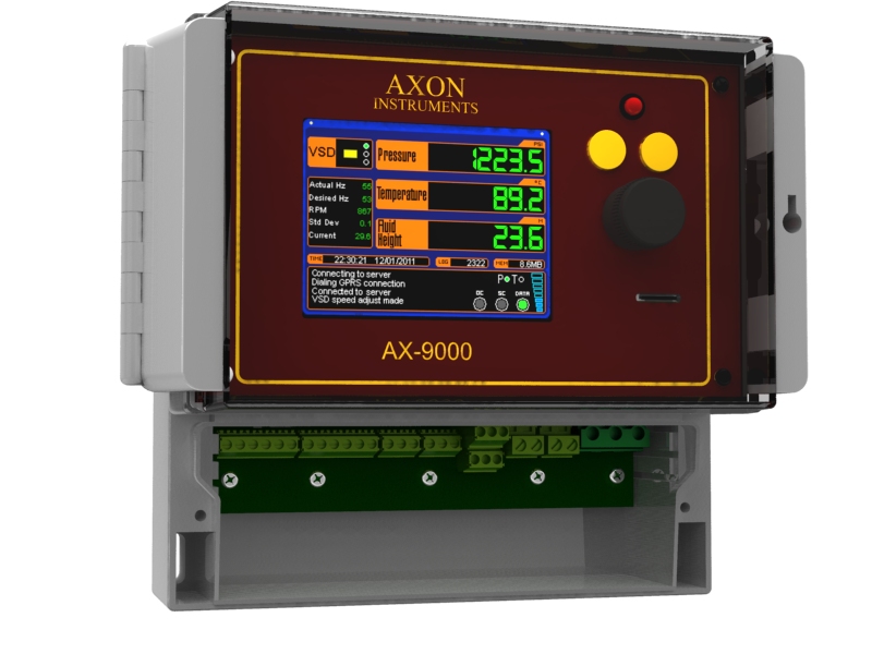

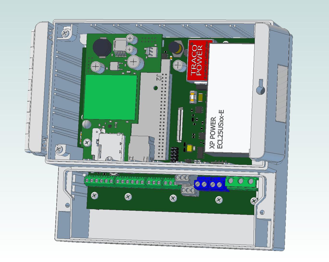

I designed a data logger around the MOD5234 and the design has an wide input AC-DC supply or +24Vdc input.
There are two RS232 ports, two RS485 ports, CAN bus and four 4-20mA sensor inputs. My plan is to use the CAN bus to expand the IO if needed.
There is also a plug in Simcom SIM300 or Telit GM862 modem boards to add GPRS or SMS capability.
It has a 3.5" LCD TFT display with touch (new 5" version in the works) and a rotary encoder with 2 buttons for input.
The MicroSD is brought out to the front panel so this has easy access.
I'll even supply the front panel design file so you can get your own made with your own logo etc or I can do this here for you.
Attached is a coupe of images.
I have a few of these installed in remote oil wells in Indonesia and they work great. I love using Netburner software to programme with as UCOS makes stuff like this a doddle (may need to translate from Scottish on this word)
PS.. I am going to be updating this to use the latest 54415 module so that I can use the new 5" 800 x 480 display to its full potential.
