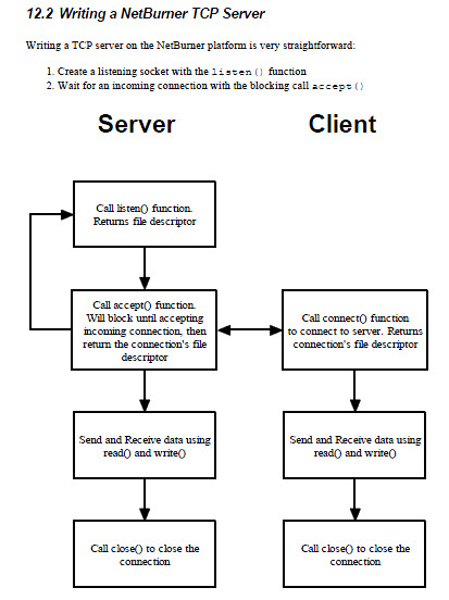

Here's also a code snippet from the example, and a flowchart from the NNDK manual:
or see C:\nburn\examples\TCP\TcpServerSimple\main.cpp.

- tcp.jpg (70.41 KiB) Viewed 5288 times
