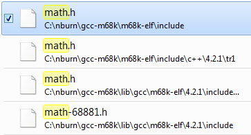

Thank you. Besides the obvious question of why is this not is any of the NB documentation, when I add math-68881.h I get a bunch of errors about "impossible asm construction" for the log function. Any ideas on what that is all about?

Adding libm did nothing to help. However, I found a Math.h file in the include-fixed directory, and when I use that, I get a clean compile. I also found the libm.pdf file you mentioned before as the documentation.
