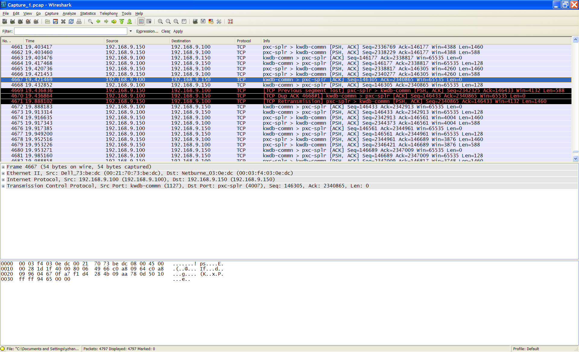

Thanks for your suggestions. I downloaded Wireshark and captured an event. The screen capture file is as attached. PC ip address is 192.168.9.100 and instrument ip is 192.168.9.150. PC sent out a 128 bytes packages to instrument; and normally instrument could response (2048 bytes package) within several ms. Sometimes (for example: Package #4669), PC couldn't receive a correct package and will send out (by TCP/IP protocol) request again, then NB will response slow (~500 ms). Is there anything I can do on either PC or/and NB side to improve the communication reliability? Thanks.

A couple possibilities come to mind, both very difficult to debug. It looks like an ACK is being missed from the PC to the netburner. Question is, was the pc busy doing something and missed the sent data, or is there something in the netburner app you wrote that has a large critical section or non-maskable interrupt that is missing the ack from the pc? If it is either of the things on the netburner side, it would be an architecture issue, since no interrupt routines or critical sections should take more than some number of microseconds. If you did not add these yourself, then I would start looking on the PC side of things first.

No critical sections there, pretty standard stuff. It doesn't make sense that packets are lost by the pc end, but that is where the evidence in this thread seems to point. I'm really not sure what else to look at, other than to look for the lost packet in your wireshark trace to see if it is there (would have happened much earlier than the picture you attached. Please don't attache a big file, I won't be able to debug it. You need to look for the lost sequence number.
If that does not show the packet, it is still not definitive. The PC could be losing the packet before wireshark sees it. You might need to add a second PC on a hub (not a switch or you wont' see the traffic) that captures all the packets going back and forth, and see if the lost packet is on the wire. If it is, then the PC is the problem. If it is not, then there is something on the NetBurner side.
