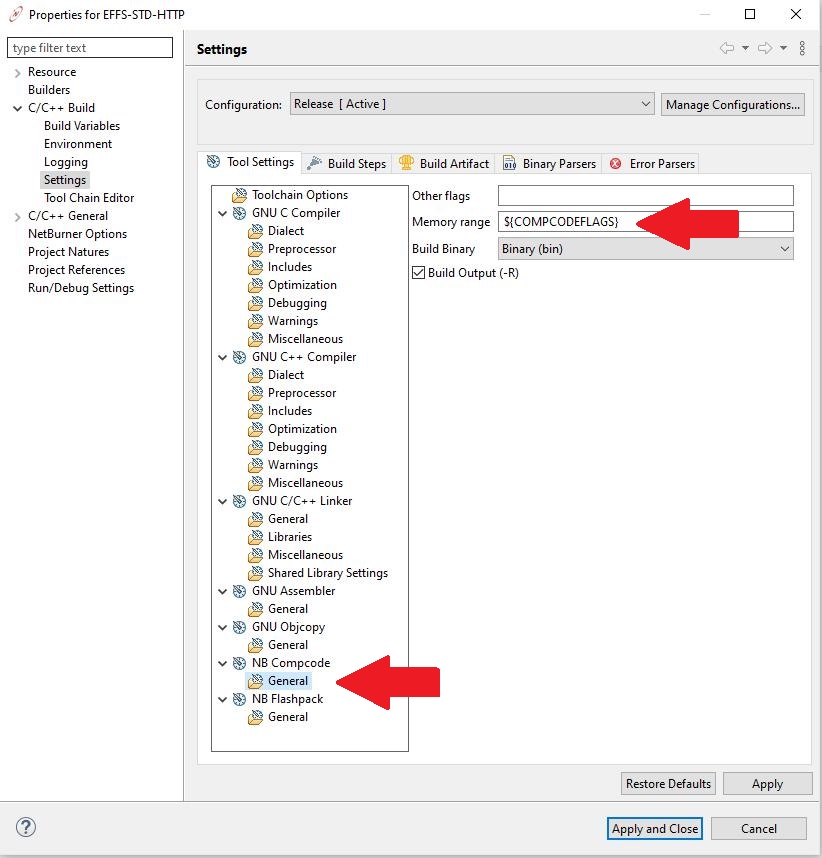

The Eclipse in 3.x does things slightly differently.
- Right click on your project and select Properties

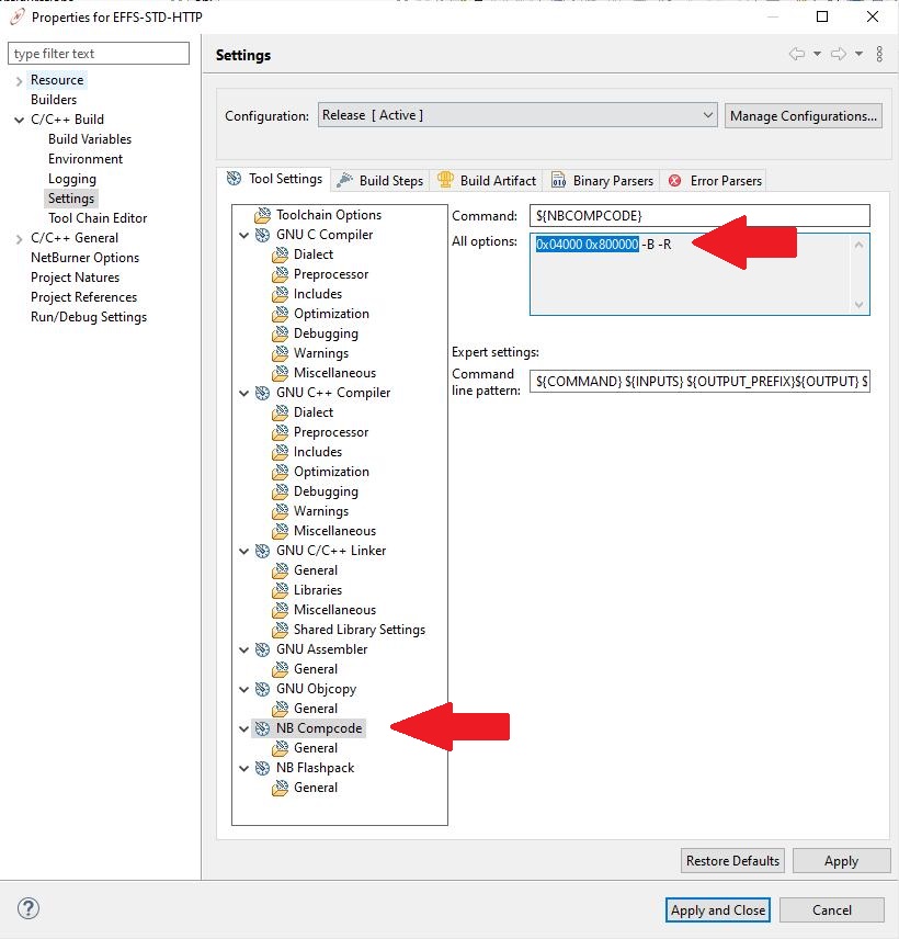

- Then go to C/C++ Build > Settings > NB CompCode
In the All Options section you can see the default memory range for the Nano. Highlight and copy 0x04000 0x800000. Leave the -B and -R options alone.

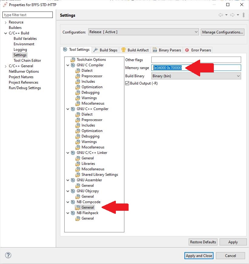

- Now go to NB CompCode > General.
The Memory Range field has a macro representing the default value for the Nano, which is 0x04000 0x800000. Paste the memory range you copied in the previous step and replace the macro, then edit it to change 0x800000 to 0x700000. So you end up with: 0x04000 0x700000

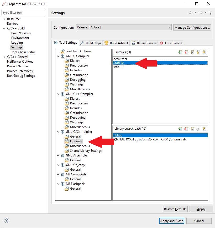

Sounds like your already added the StdfFile library, but if not, make sure you do:
