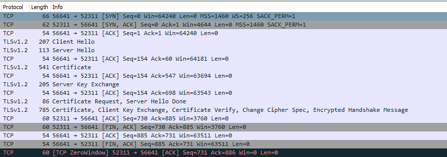

looking in the wireshark, there's no client certificate request in server hello message during the handshake.
update:
strangely, when I reboot the module, and tried establish a tls connection with peer verify = true. This time, I did see a certificate request in the server hello of the tls handshake. There's no any firmware update, all I did just reboot. However the connection still established while the client didn't send any certificate.

Now as my desktop applicant provide a client certificate during the handshake, the module will reject the connection request. It send a tcp FIN packet right after it receive client cert.

Thanks Jon. The reason my client cert got reject because I convert a pem format of client ca cert to a cpp file using compfile. Instead I convert to der format first and compfile to cpp file. and set the parameter format to SSL_FILETYPE_ASN1 in ssl_accept();
