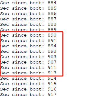

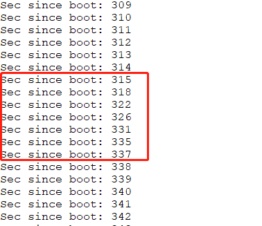

I created a simple helloworld app that use the same mechanism to communicate between the webpage and server. Instead the main loop hang forever after 5minutes, this time it hang 3~5 second several times for every 5 minutes with the webpage open with https in Firefox. After that, the server will respond back. Still not sure why what cause it. Please see the attached for the simple program source code and debug output.
- debug3.png (9.75 KiB) Viewed 8503 times
- debug2.png (8.1 KiB) Viewed 8503 times
- debug1.png (9.68 KiB) Viewed 8503 times
