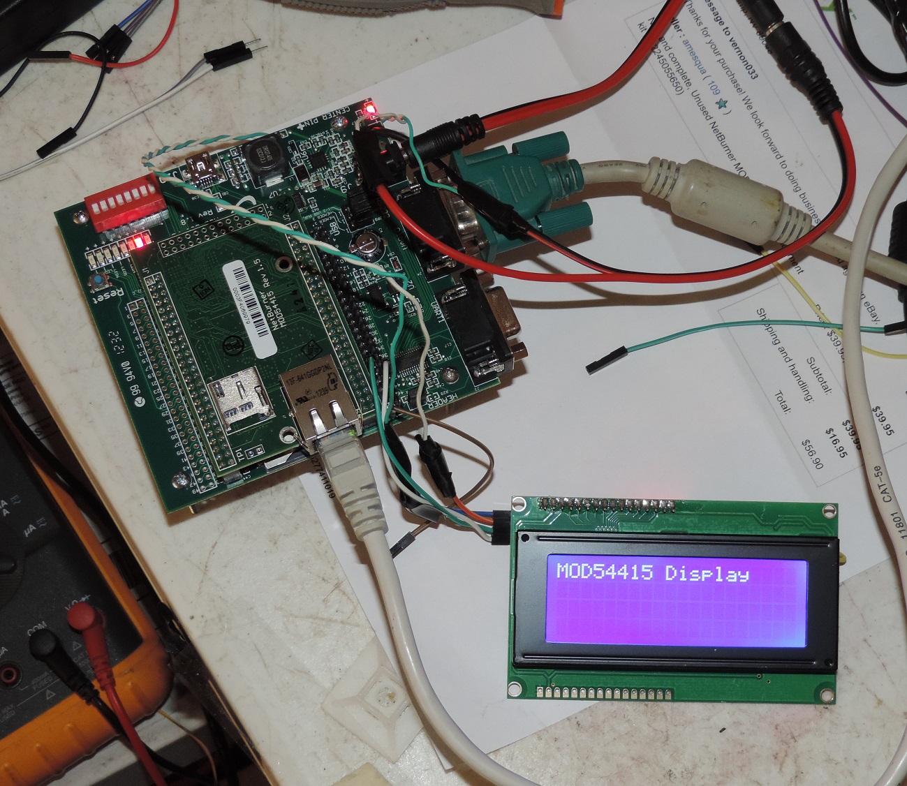

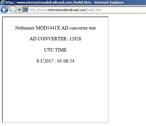

I have not drafted up a carrier board yet but did write functions to run an I2C display, the on board RTC, RC servo compatible PWM, and the A/D.
https://www.youtube.com/watch?v=-WKdFDBbrxE
The above video shows control of a servo on PIN 19 over the internet using a gamepad. I just got a graphic SPI display from China and will be playing with that next.

Interesting but somewhat pricey. I use the above 4 x 20 I2C display at $8.75 (even less if you want to wait for mail from China). Essentially it has an I2C port expander mounted on the back and those modules are about 62 cents each. Port expander below and you could use it for any GPIO application if you wanted.

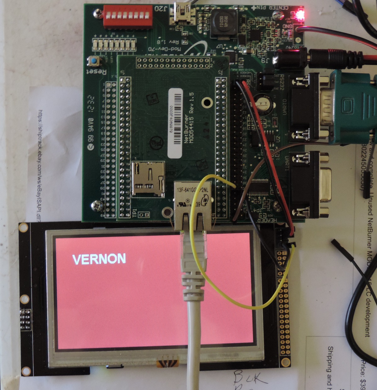

My name in lights! I got the $29, 4.3" LCD display at the website below.
http://www.buydisplay.com/
It was a pain. I ordered it configured for I2C and the little solder jumpers were wrong. Had to fix that. Then they don’t know the standard for an I2C address and the number they give is shifted one bit. And while it only responds to its own address it acknowledges any address which creates a problem if you want to use another device on the bus. The display is the only I2C connection in the case of my current MOD5213 applications so that is OK and the MOD54415 in the picture has multiple I2C. But I am going to complain because this ain’t right. Pretty nice for $29 however. Pic attached is with the PWM for the backlight turned down to save power – it looks a lot better with a normal backlight.
I might try selling these on Ebay for $50 with a Netburner sample program. I have a lot of work to do on said sample program however so that will be awhile. I know the background looks pink on here - but it is actually red. I can of course set the background color as required.

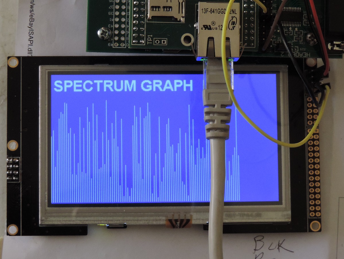

Made a spectrum graph using random numbers (limited to a range) just to see how it looks. A 4.3” display is about the right size for various projects and is about the size of the phone people are used to looking at. It is also thin so nothing projects close to any circuit board you might want to mount underneath it.

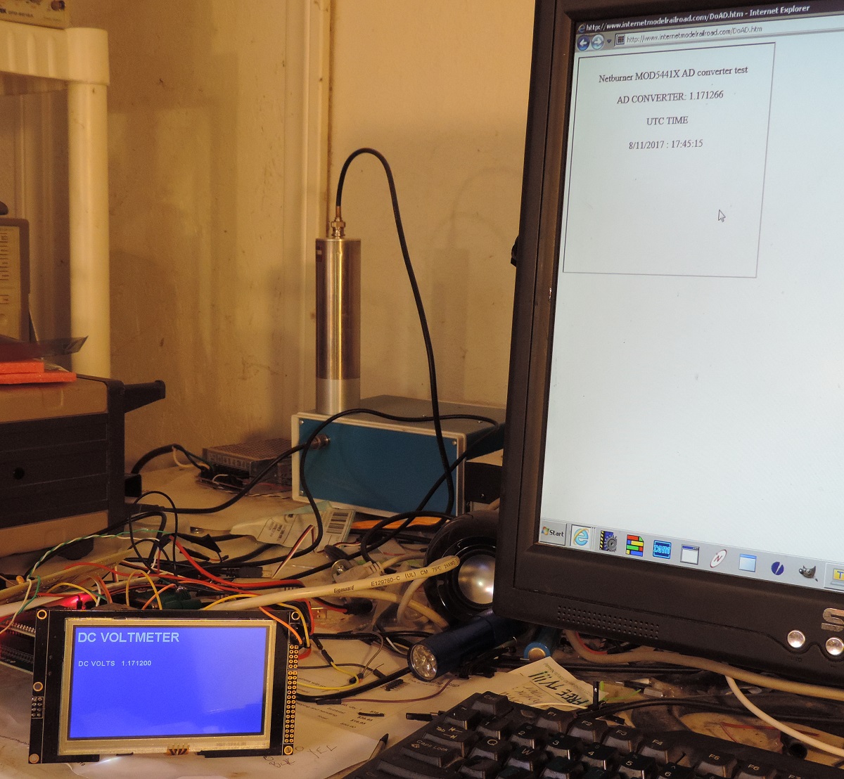

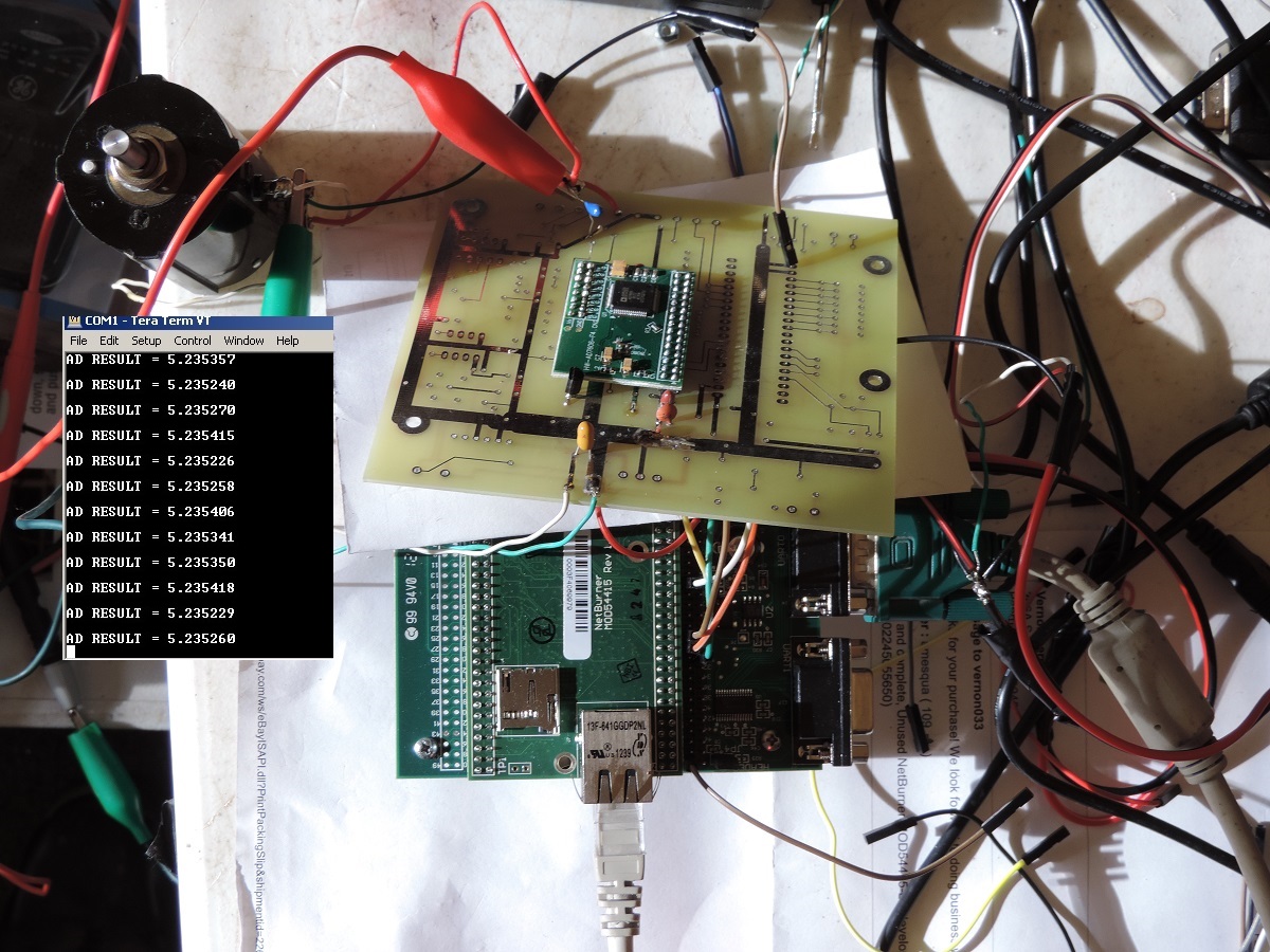

And then any IoT device needs precise data acquisition so I put an AD7606 module ($17 on Ebay) on a board I normally use with a MOD5213 and connected it with jumpers to the MOD54415. Works great. The values coming out the serial port are very close (see inset in the picture), there is very little noise, and it reads 5.2353 basically. The reading on the Keithley DMM is 5.23586 so about 0.01% error and that is the error between 0 and 8V. The range is +/- 10 but the wall wart is 8V and I have a big multi turn potentiometer attached to it. Just wanted to make sure my DSPI function worked.
Will probably make a circuit board to carry the MOD54415 module, this AD, and a few other useful chips. It will connect to the new display. Would be good for stuff like a permanently installed and internet connected AC power system meter. Or a NEST like thermostat. This A/D offers a 200KSPS sample rate and is good for anything from DC to getting 60HZ amplitude and phase angle - and even digitizing audio. The +/- 10V bipolar range lets you do about anything with precision.

Picture shows the MOD514415 putting the AD result from the AD7606 on the internet and the display at the same time. The values are slightly different because the internet only updates every 500 milliseconds and each sample is slightly different. Any reading across the voltage range is within 0.02% of the standard Keithley lab DMM however.

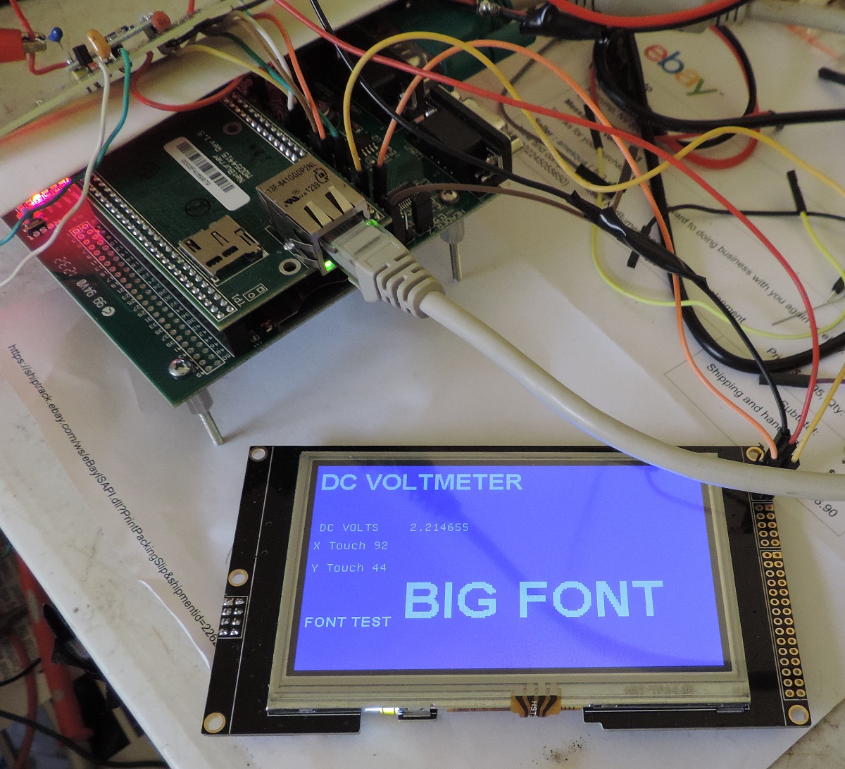

Fonts out the wazoo!
You know you want one. This display $50 plus shipping and I email you the functions that you can cut and paste in to get started. This saves you the wait on mail from China, about a days work getting it going, and it is tested so you know it works! Hook up 4 wires and read the screen!
7" display, same IC with a few relevant numbers changed in the code, $65!
