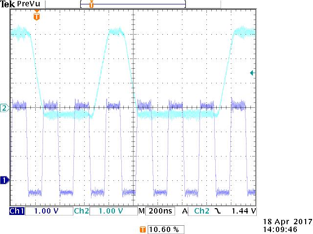

Regarding DSPI channel 1, SOUT (serial out).
Is there a way to speed up the slew rate of the SOUT (serial data out) signal ??
I can't find anything in the MCF5441x manual about how to increase the slew rate (faster rise and fall times) for channel 1.
With the existing slew rate, see attached scope shot, the channel 1 clock (data) rate is limited to approx. 3.9 MHz.
I have it set up to sample on rising clock edge.
I hope I'm missing something, I'd like to run the channel faster.

Look at section 15.3.8 of the MCF54415RM.pdf.
In nburn/docs/freescalemanuals/
I believe that
#include <sim.h>
sim1.gpio.srcr_sdhc=0xFF;
Will do what you want.

Great. Thank you. I didn't think to look at the 'other' pin function name register (duh). I'll try it right away.

Are you running the DSPI driver or a custom one? The DSPI driver sets the slew automatically based on configured clock speed...
