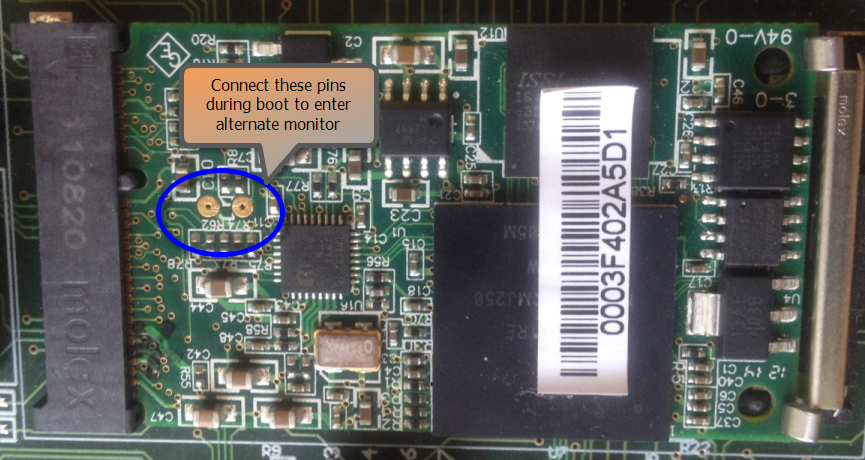

Things were going just fine, and i performed a rebuild all to my project as i was getting ready for the release stage.
Clicked upload and the board did nothing. Opened the serial port to see, and after boot i am getting this message after reboot.
Boot record INVALID Csum:FFB6

Even when i upload a totally different project i get the same.
Any ideas ??
Re: Boot record INVALID Csum:FFB6
Try shorting the monitor pins to enter the alternate monitor first. Then, upload a new project like normal. If your project is failing, try a default example application. The alternate monitor should provide a network connection, so uploading via NBEclipse or autoupdate will work.

I actually knew about the pins, i tried it after i posted this, i just forgot to update it.
That fixed it. thanks.
