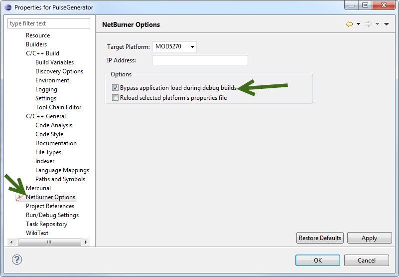

If you have a running debug image in a Netburner, is it possible to get the Netburner Eclipse debugger to attach to it without rebuilding and reloading the application image?
Re: Attach debugger without rebuild?
Use the project-properties dialog. Scroll down to NetBurner options and enable the Bypass application load during debug builds.

Perfect. Thank you.
