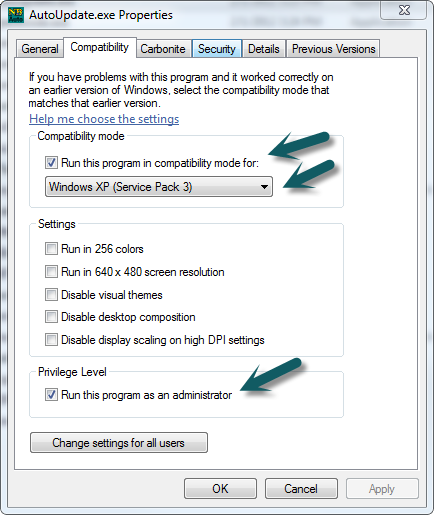

I just downloaded the latest NNDK last week and that's not happening to me. If you're trying to do autoupdate from inside Eclipse make your first step trying to do it outside of Eclipse. Launch autoupdate.exe (nburn\pcbin\AutoUpdate.exe) from the Windows explorer. If that doesn't work, try right clicking on the .exe and setting the compatability mode to XP and enable it to run as admin (see the image - assumes you're running Win 7). Is it possible something OS related is asking for the username and password?

thank You for the answer. I tried to do it as You wrote, but it didnt help. I have no problem to download software to other modules I have (let's say I have 10 of them). It seems it is connected with that one specific module itself. IMHO this module had already been by customer and it came back to NB for repair or NB had tested some application before they sent it to me. So there is an user/password set from previous app.
The XP compatibility issue - I am Win XP user, so I hope it runs in XP compatible mode as default.
