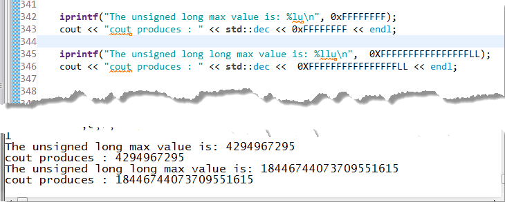

I just tried it on a 5272 (for one more data point) and it iprints correctly there as well. Does the MOD5213 have a unique stdio.h file? I would have thought all the platforms shared nburn\gcc-m68k\m68k-lef\include\stdio.h and I therefore assumed the code itself was in NetBurner.a not MOD5272.a, but you know what they say about assumptions.
Maybe try doing it with straight literals (no variables) like shown below and another data point might be to try cout.
<iostream>
std::cout<< 0xFFFFFFFF <<std::endl;
does too.
<iostream>
does too.

Re: MOD5213 iprintf() error for UL and ULL types?
I just took a quick glance at the 5213 data sheet, on second thought don't try cout, you'll probably run out of memory.

Tod,
MOD5213 iprintf() shows problem for both variables and literals.
MOD5234 iprintf() works fine.
