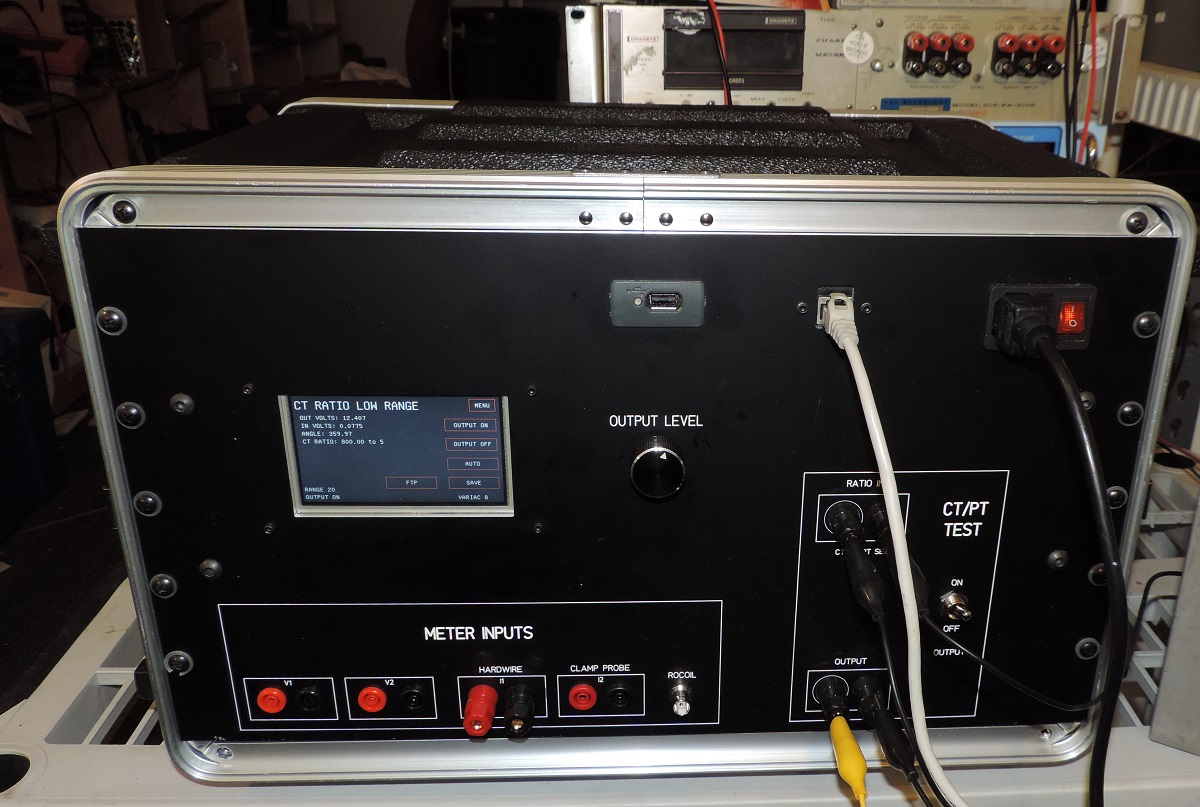

Posted: Tue May 15, 2018 9:13 pm
by Vernon
My latest - a current transformer test set based on the MOD54415 !
