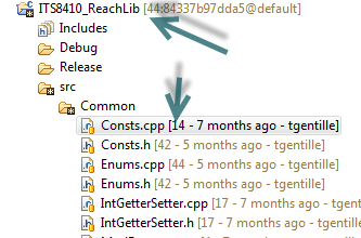

You'll probably want to take a glance at the wiki article on using standard Eclipse releases. I have found using NBEclipse with additional plug-ins problematic (but I haven't tested it recently). My suggestion is to stick with the CDT Indigo release of Eclipse. I think Eclipse EGit comes with the standard CDT Indigo release. I prefer HG so I use MercurialEclipse.
I use pre-build steps to incorporate HG version info into my overall version information. I have commands that report the firmware version to the user. My philosophy is to not litter my source code with version information, to me that is one reason why I use a source code control system, and that is where the revision information belongs. You can tell MercurialExlipse to show the version info automatically in the project explorer. By default it only shows the latest revision of the project but a simple checkmark will show the current revision for each file. See the image. The overall project is at 44 but some files shown are at revisions: 14, 17, 42 and 44.
Regarding item 3. I would probably use one installation but two workspaces.
