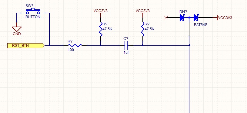

Thank you kindly. I've attached my schematic for the reset generator. Any suggestions?
Re: MOD5270 Internal Reset Circuitry
I think the MOD5270 already has a 4.7K pullup.What you show should work.
