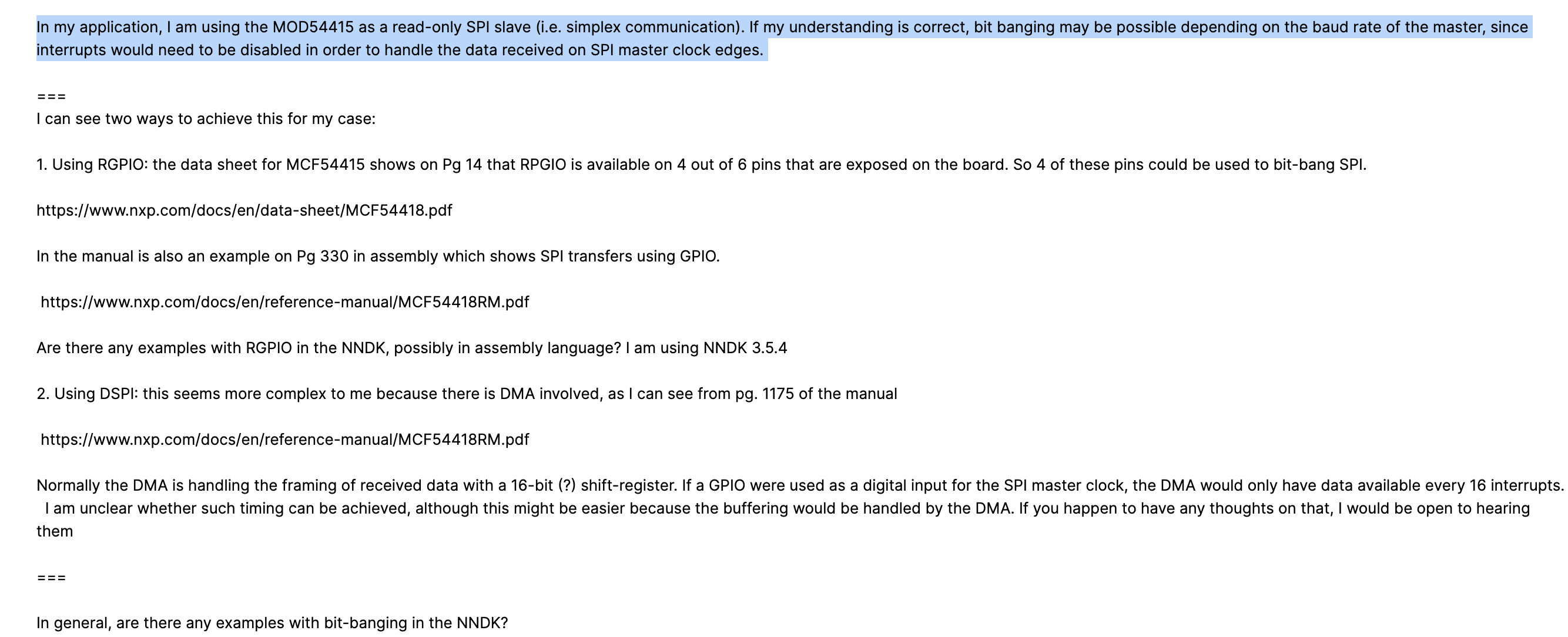

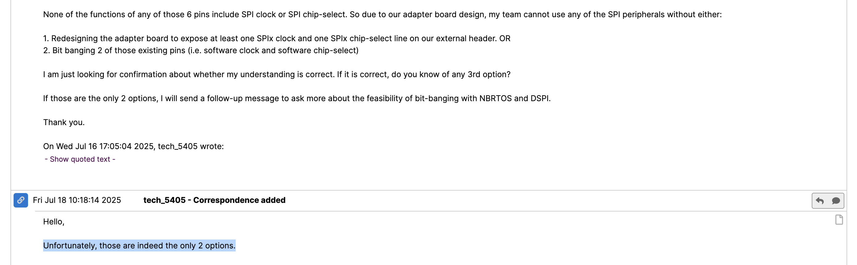

Here are some take-aways from the discussion:
1. The only pure firmware-based solution to the above problem is bit-banging
Bit-banging is the only firmware-based solution

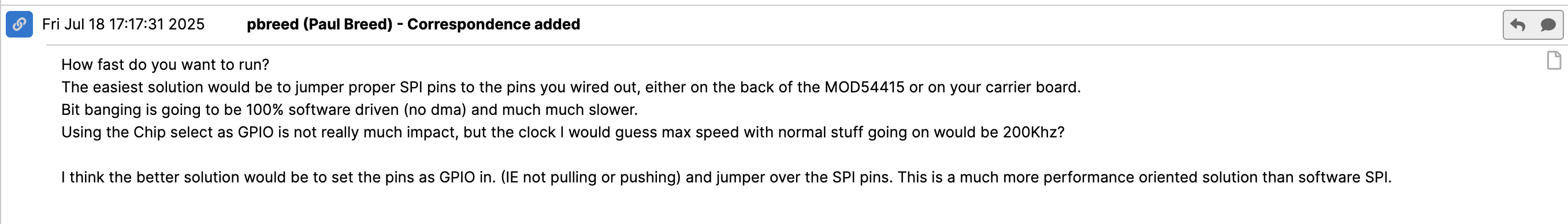

2. Bit-banging is much slower - it depends on the baud rate of the master
Bit-banging depends on rate of master
3. A much better hardware workaround is to jumper the SFIO pins that are inaccessible to GPIO pins that are accessible.
Better workaround is jumping
