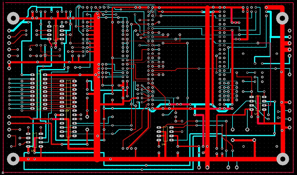

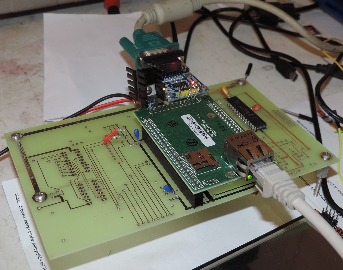

Re: Carrier Board advice needed?
I have had great results with a MOD5441 carrier board using large ground traces to prevent ground bounce (see pictures) and 1.0uf and 2.2uf bypass capacitors at each 3.3V terminal of the module. I also use a 10uf cap at the output of the 3.3V linear regulator. I use a similar board (in fact the picture of the bare board below is that board) on my internet controllable model RR and it has been running trouble free for several years.
Never tested RFI generation but have used both SPI and I2C with great results as far as functionality.
I use an MCP23017 port expander (I2C) for IO and a ULN2803A to drive relays. You can get relay modules on Ebay that will connect to the 2803A and switch 24V at 10A just fine. You can jumper the 23017 to get 8 different addresses if you need more than 16 IO points.
Note that you can search on Ebay for "RFI enclosure" and find die cast enclosures with a gasket. Hint: if you can put your phone in it, call your phone, and not have it ring it won't fail the test with your electronics inside.

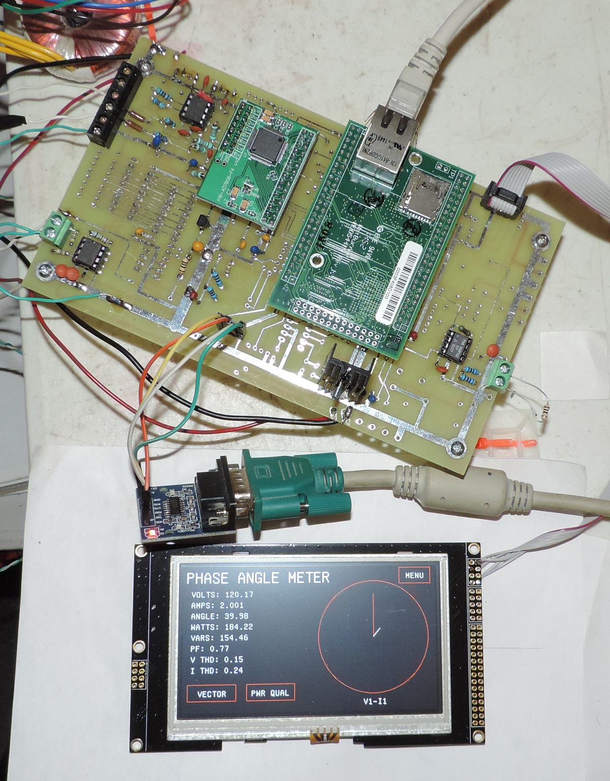

Built this MOD54415 carrier board today - set up as a phase angle meter - selectable for two voltages and three currents.
Works great and they simply vector airliners around Pahrump, Nevada (where I live) when it is on - so the GPS keeps working.
Just kidding - I did test it (not exactly scientific) with the phone in FM radio mode tuned to a weak station and the display seems to make the most noise. You don't get anything from the processor module or the rest of the board beyond about 3 inches. The display has about a 3.5 inch noise radius but is louder in direct contact. Nothing that being in a steel box won't fix. I mount it in an ammo can.
My current transformer test set http://www.cttestset.com uses a 68HS12 (kind of a 16 bit HC11) on the measurement board and an ARM 9 Mini2440 (now end of life) on the front panel. I am going to switch it to the MOD54415 because the number crunching power let me devise a new FFT based algorithm that delivers the whole kitchen sink when measuring one cycle of two AC signals and does it in 120 microseconds. Amplitudes, Phase angles, harmonics and so on - and it is mostly done in double precision floats. You can only do simpler stuff with the HS12 - real simple considering I program that in assembler where I am not much good at higher math.
