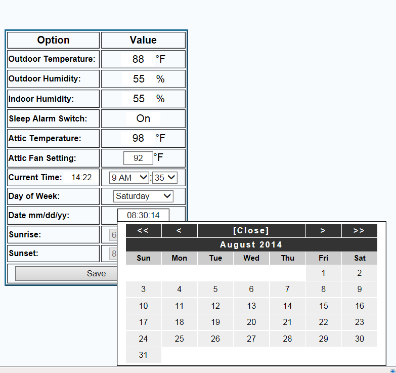

Now is where the Home Automation System was needed. I kicked around a few ideas, should I use MS Visual Basic for a GUI? I thought better of it and decided to go with the NetBurner PINK70
Using PicBasic Pro I set out to tackle this project. I had to learn HTML to work with the PINK70. My HTML code worked but was not pretty and needed cleaned up..
Basically it operates like 5 individual 'set back' thermostats. aka programmable thermostat.
With 'Wake', 'Leave' ,'Return', and 'Sleep' times and temperature settings for Monday through Friday, then Saturday and Sunday have 'wake' & 'Sleep'. I went so far as to have a switch on the nightstand next to my alarm "Sleep alarm Switch" to switch between Work Day and Non-Work day settings. "On" = Work day; "Off" = non work day.
Just using the left most switch at this point...3 more for expansion
