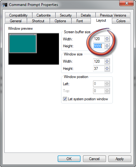

I tried changing the settings under Window->Preferences->C/C++->Build Console, but no joy. Just in case you don't know, you can increase the DOS windows virtual size to 9999 lines. Drag a shortcut for the DOS prompt somewhere convenient, then right-click it and select Properties. See the attached image.

And thanks, Tod. I think I knew about the ability to expand the DOS window but it had slipped to the back of my dusty mind. The make > make.txt works nicely since it only shows the errors in the window, but everything is in the txt file if I need to see it all in context.
