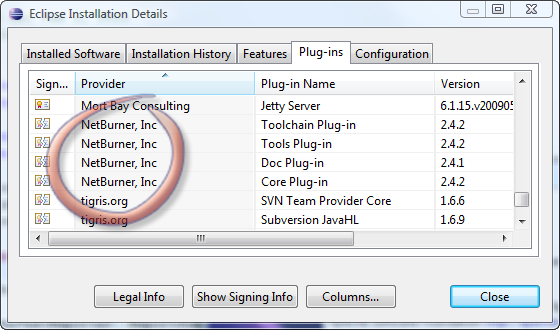

how are you guys using the nb plugin in gelileo, i copied the 3 files and 1 docs folder from the plugins directory to galileo plugins dir but have had no luck getting it to work... i am using 2.4 RC2.
Re: CVS gone?
I do a normal install of the NNDK (including Eclipse). I install Galileo normally. I make sure I quit Galileo then I then copy the three files (nbeclipse.core*.jar, nbeclipse.toolchain*.jar, and nbeclipse.tools*.jar) from the NBEclipse/plugins folder to the galileo eclipse/plugsin folder. ( I also copy the doc folder over) Then I start Galileo and it works.
I know someone else on this forum recommends installing Galileo into the nburn folder but I didn't have to do that.
What is happening? If you go to the about screen and click details and then go to the plug-ins tab (wait a minute for it to fill in) and sort on Provider do you see the four NetBurner, Inc. entries?
