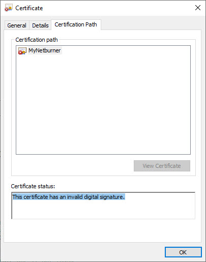

I am doing SSH R&D, and I started with example SSH/sshServerUserAuth. It build and runs fine.
In the example it call to generate a cert and key if there isn't one available for use. So I add a dummy html and enable HTTPS web server in the project. the certificate I download from the web browser indicate the certificate that generated has an invalid digital signature.
then I build the example, SSL/SslOnboardCertGeneration/Simple without any modification. It's the same result.

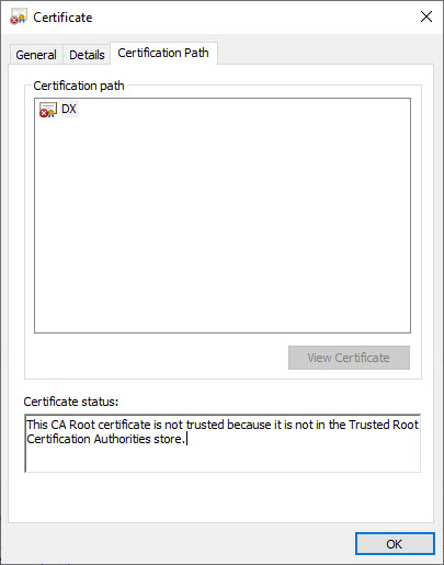

for a comparison, this is how it looks when I generate a self signed cert using OpenSSL, you're seeing the the cert is not trusted that's because I've not install the cert into the CA store yet.

with further troubleshoot, I found that was caused by the signature algorithm mismatch with the public key algorithm in the certificate.
Since it's a self signed certificate, the two algorithms in the cert need to be the same, either RSA or ECC.
If a cert was signed by a CA, the signature algorithm in the cert need to match with the CA encryption algorithm.
The fix I make to SSL_CreateNewSelfSignedCert(CertGenData & GenData) in \nburn\libraries\crypto\NetBurner\NbCertGen.cpp
#if defined(SSL_KEY_ECC)
    gNewCert->sigType = CTC_SHA256wECDSA;
#elif defined(SSL_KEY_RSA)
    gNewCert->sigType = CTC_SHA256wRSA;
#endif

I examined the onboard certification generation code and agree with your assessment and fix. I am working on improving the selection logic around selecting a DEFAULT_KEY_TYPE to be used, instead of relying on a plethora of defines. This should arrive with the next release. But in the short term, your solution is both valid and will be used. Any fix put in to place around selecting the key type will be backwards compatible.
I'm curious, what method did you use to set RSA as your preferred key type?
