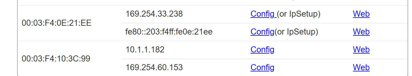

If someone uses only AutoIP, the discover server will not be accessible either, so use the localdiscover utility instead. I have attached a screen shot of my device with ending mac address of EE.

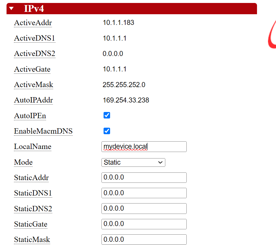

Additionally, providing that BOTH the PC and device are configured for the same local network (in this case PC is using an AutoIP address as well), you can use the LocalName option. In this case I used mydevice.local. That way you don't need to remember the IP address.
Screenshot 2024-11-26 142424.png (68.83 KiB) Viewed 219422 times
