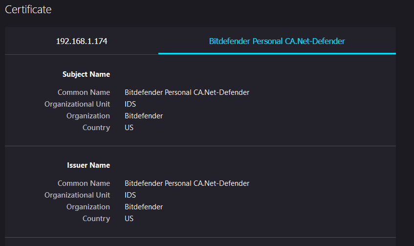

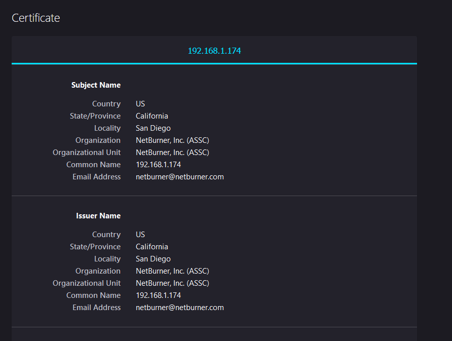

Something else I have noticed on my system. With BitDefender installed, it does it's own certificate check, and I see a bit defender cert, not just the netburner autogenerated cert. Looking into it now, but I think actually goes out and does it's own check in it's cloud database check, which takes more time. I've attached cert screen shots from firefox showing bit defender enabled vs disabled. Only a sample size of 1, but in my tests takes a lot longer when bitdefender is involved. I think that is what they call their zero-day attack feature.
- bitdefendercert.png (23.1 KiB) Viewed 67257 times
- nbcert.png (34.39 KiB) Viewed 67257 times
