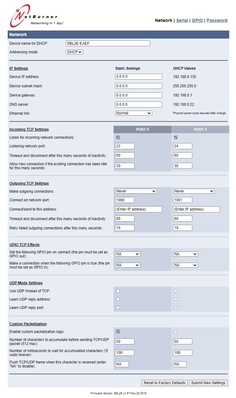

I am using the SBL2e out of the box and making settings through the web interface / index page on the card itself.
I am using the card to send visca commands, which terminate in 0xff (255), and I would like to flush the TCP frame on this character.
The web interface only allows the flush character to go up to 254, and NA's it if I enter 255. I assume this has something to do with telnet.
Is there a workaround for this?
The timeout is not a great solution, because it introduces long unnecessary delays on short commands.
Counting characters is not a great solution, because the commands are of very different lengths and it will revert to the timeout the great majority of the time.

The unit does not seem to flush on 0xff with the flush character set to NA.
FWIW I have SBL2E v1.67 Nov 29 2016. Settings are below.
Here is what I did.
1. Reset to factory defaults from the configuration web page
2. Select custom packetization 50, 100, NA. (did not edit any box, just set checkbox)
3. Click submit new settings
4. Sent 0x81 0x21 0xff on the IP side (expected response: 0x90 0x61 0x04 0xff)
5. Response is 0x90 0x61 0x04 0xff. Takes 100+ ms (clearly timing out and flushing at 100 ms).
6. Set flush character to 4 (==0x04)
7. Sent 0x81 0x21 0xff
8. Response is 0x90 0x61 0x04. Takes 2+ ms (clearly flushing on 0x04).
