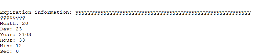

and here's the output I use your function:

I think the problem is about SSL_GetExpirationDate() since it did the job to get the expiration date of a cert.
Re: validate cert and private key
Posted: Wed Mar 24, 2021 2:05 pm
by RebootExpert
Or is the function specific for the self generated cert use only?
