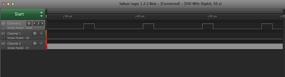

Well, that was easy... It's not quite 100% accurate as a PWM output, but it's fairly close.
