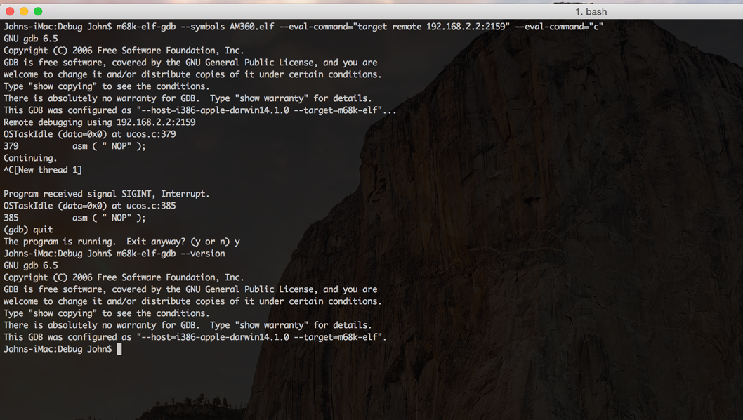

I was just curious if there were any plans or a timeline available on when network GDB would be included /w NBEclipse for OSX.
I was able to get it working by re-building the m68k-elf manually (it took me a lot of googling to find the a similar version as the windows one)... As you can see from the screenshot it works just fine. Although, I can't seem to get it to work /w the NBEclipse GUI - I couldn't locate the source java files for the NBEclipse plugins.
If anyone else is interested in how I got it working/compiled just let me know and I'll write out the instructions on it.

Paul came in to ask about this and I gave him the wrong answer. You are correct, debugging is not in the OSX release. I'm not entirely sure why it's not in the OSX release, as the gdb build requires no modification to the source. Seeing that you have the command line working, I may be able to get the NBEclipse side of things working as well. It's friday at 5pm, so next week I'll get back to this post and see if we can get this feature working.

I now have network debugging working on my macbook. Unfortunately, there are some software fixes to make this work, so it's not a matter of just changing some settings. These changes will be in the next release (2.7.4), which is looking to be 4-6 weeks out.
The next release will include gdb 7.9.1 on the osx release, and NBEclipse + GDB will work out of the box.

The backend work is in place in 2.7.5. ie, if you have your own m68k-elf-gdb in the bin directory and you try to debug in NBEclipse, it should work.
I just tested 2.8.0 (new upcoming beta) and it works. In 2.8, gcc5.2 was built in to the release, and includes the OSX gdb version.
