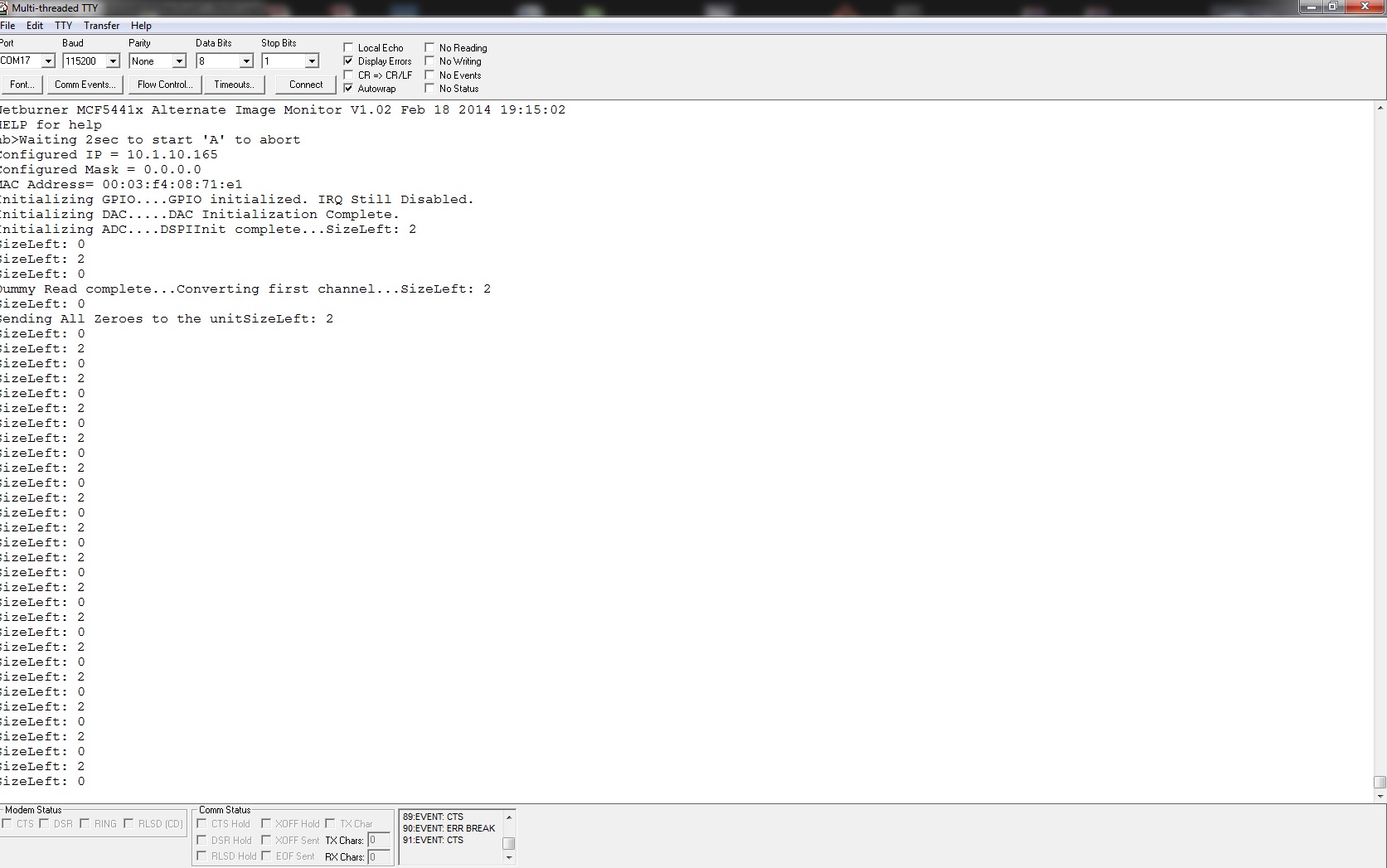

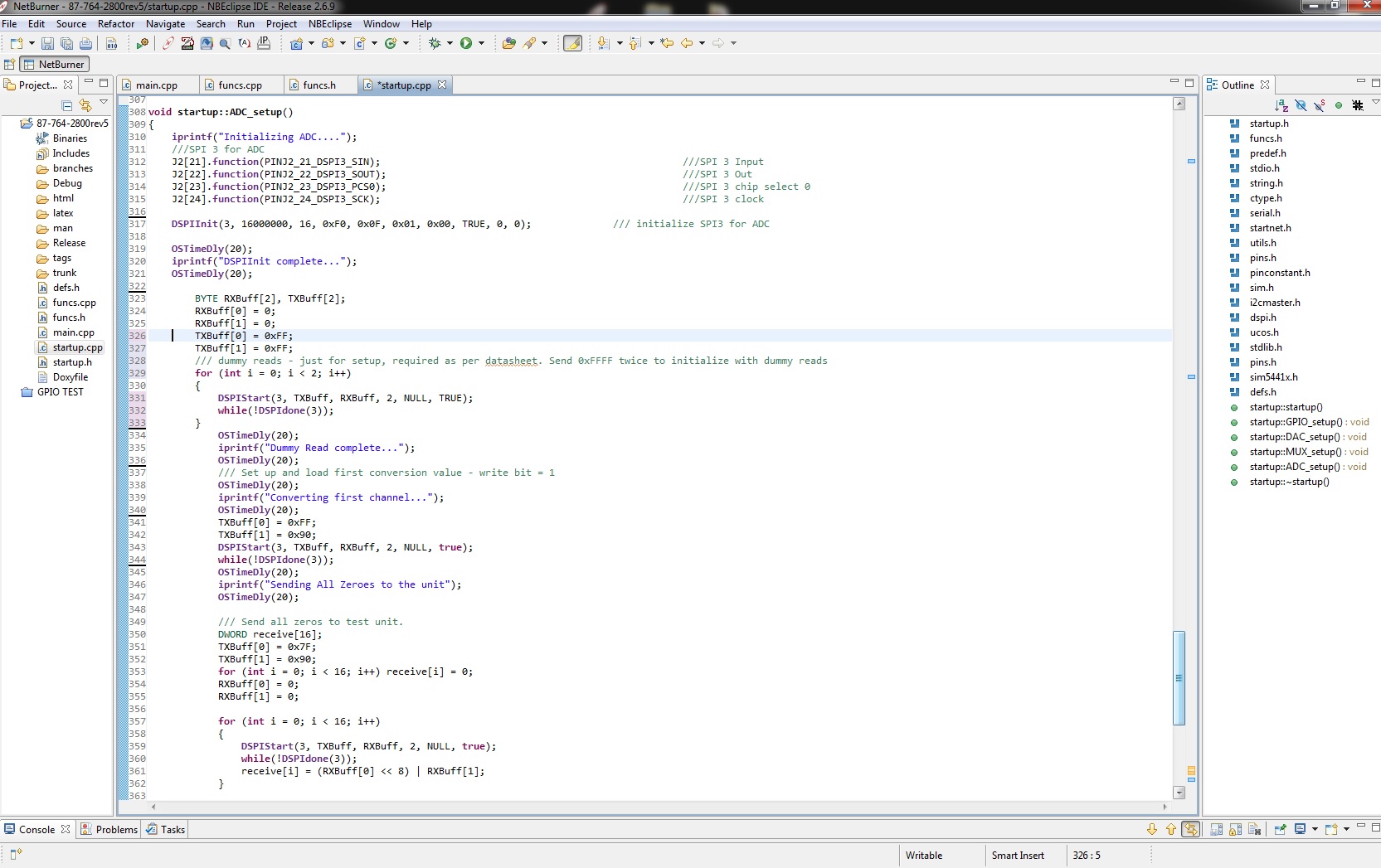

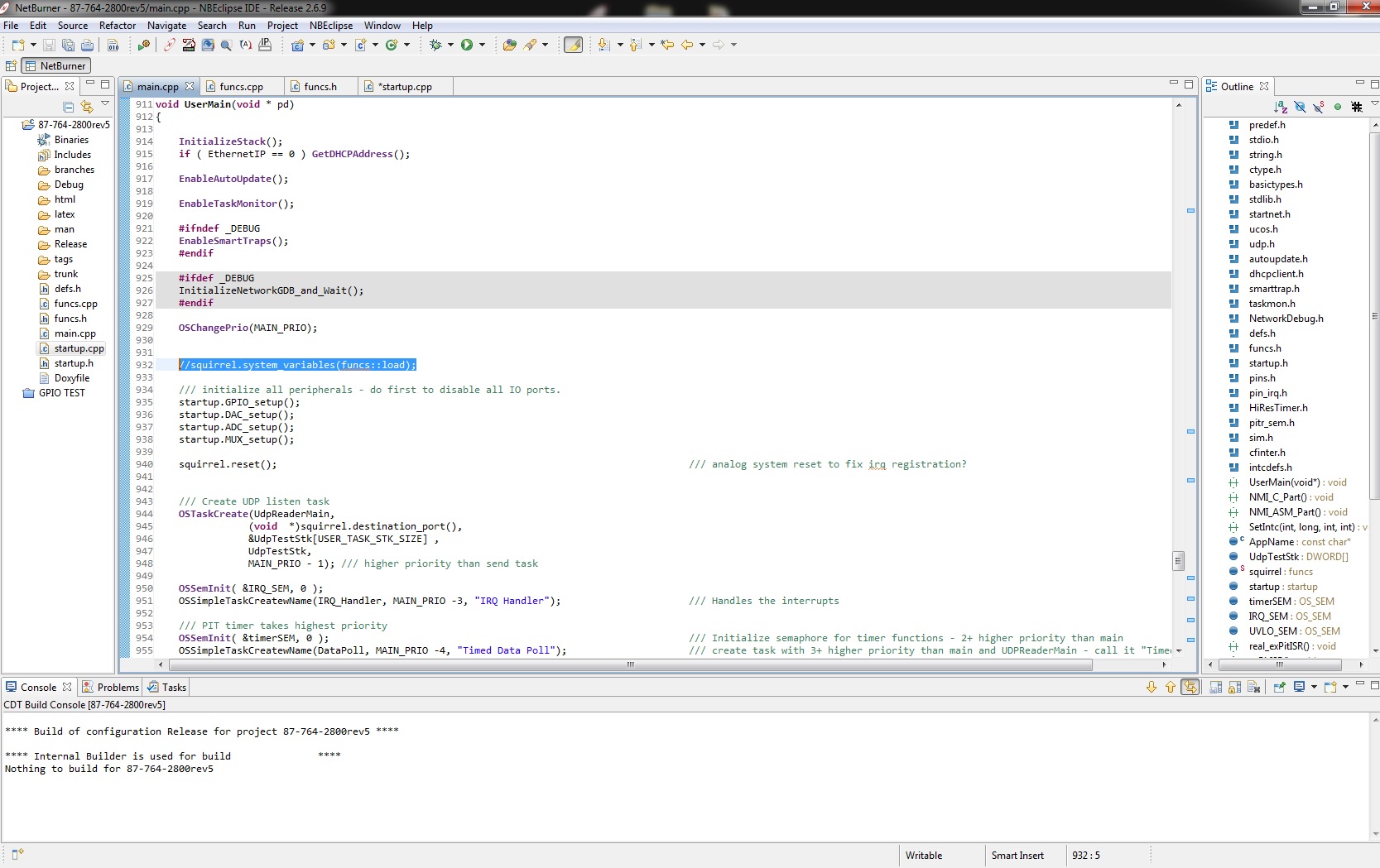

I loaded my firmware into a unit, and had a few bugs but I can't figure out one of them. When my unit loads, it initializes the GPIO being used as just IO, Then a DAC, which loads fine, then a SPI controlled ADC. This worked perfectly in my last version of my software so I never touched the code, but right after my DSPIInit function, as it begins to send a dummy read command to the ADC (mfgr spec) the task monitor (I believe) splashes the screen with "SizeLeft: 0" or "SizeLeft: 2" - not sure what this means - Screenshot attached. I should note that I originally had code that loaded values from user flash prior to loading the peripherals. I have since removed this line of code. I also attached a few screenshots of the code, sorry, not allowed to show any more of it... And sorry if it's squashed a little, had to cut out a few comments to get it all on the page.

- This is the init function for the ADC.
- ADC_load.jpg (338.74 KiB) Viewed 25772 times
- Section of User_Main() that calls the class functions and shows the commented out load function for the user flash area.
- usermain.jpg (348.21 KiB) Viewed 25772 times
- MTTTY output
- SizeLeft.jpg (216.45 KiB) Viewed 25772 times

It is unlikely that the "SizeLeft" output is coming from TaskMonitor; that code is only invoked by the TaskScan utility when you run it from the NBEclipse IDE.
It is more likely that there is a printf() statement somewhere in your code that is outputting "SizeLeft". You should do a file search for that statement.

I'm don't fully understand TaskScan enough to understand how to interpret what I see. I can tell you this though, this is occurring in one of my startup functions. This function hasn't changed since Rev3 of my software and has always worked. I only just recently added iprintf statements when I noticed that my system was locking up at startup. I sometimes do that in lieu of running the debugger so that I don't have to disable any of my timers or the cwt (Still learning a bit...). None the less, my iprintf statements end before the main while loop. None of my iprintf statements are outputting "SizeLeft". This output is occurring in a loop that has no iprintf statement. It is the 16 count loop under the "ADC_Setup()" function.
This is the loop:
Also, I did not run the debugger if that's what you're referring to. I'll try loading it through "AutoUpdate" to see if that makes a difference.
