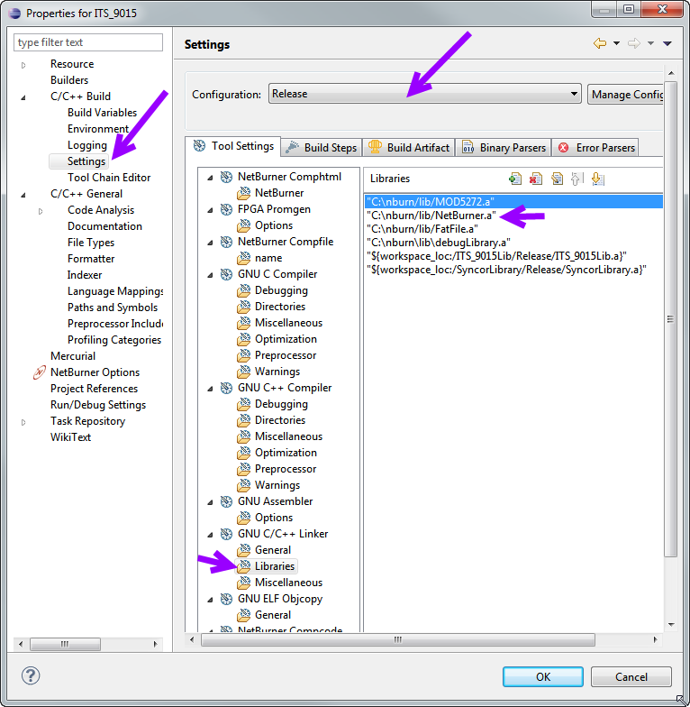

I don't have a NANO setup to give you a specific answer but in general:
1. Is DBNetburner.a in your nburn\lib folder?
2. If the Release build is working and debug build is not it's usually just a settings issue. You can go to the project properties Then use C/C++Build->Settings on the left and Then on the Tool Settings tab look under the GNU C/C++ Linker and click on the Libraries option. At the top of the window is a selector for Debug/Release/All. Just toggle between Debug and Release and see what is different. One obvious difference will be Release will want NetBurner.a and debug will have the DB prefix. But I know some modules use an _sc version of the libraries. If the release uses a different version then so should the debug (with the DB prefix).

There is no file DBNetBurner.a in directory nburn/lib. The files in the linker settings are the same name between Release and Debug with the Debug files being prefixed "DB". Otherwise, same number and same base name.
I should have said that I'm using v2.6.8. That may or may make a difference.
