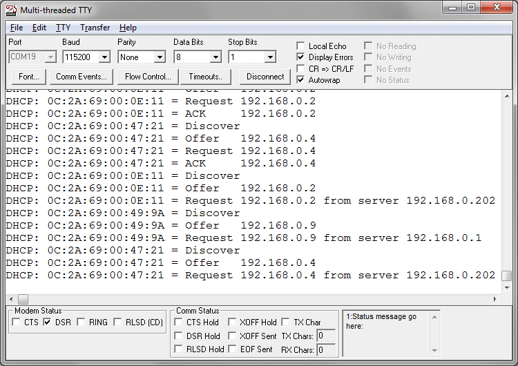

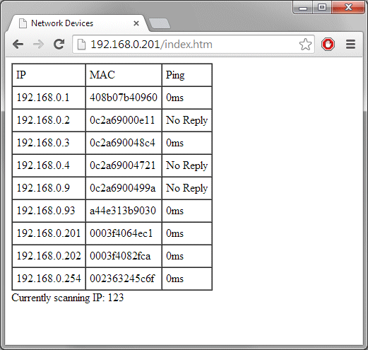

I too have been working on building a DHCP server. Started it a year ago, finally got it finished up. While this isn't integrated into the network stack like the official Netburner one is, it does have the following features:
- Will scan the network for devices by pinging them and checking the ARP table. IPs found to be in use are not available for DHCP to hand out.
- Can function with more than one DHCP server on a network - if a client accepts an IP from another DHCP server, we update the pool with that client assigned to the IP they accepted.
- The pool is saved to flash, so a reboot of the system doesn't clear the pool. The devices that were on the network before will still get assigned the same IPs.
- Clients not seen for twice the lease time get removed from the pool, freeing the IP to be assigned to another client.
- A webpage to see IPs, MACs, and ping times.
This is intended to be used on a typical 24 bit subnet (255.255.255.0) as the pool only stores .1 through .254. It has two tasks, a high priority task to respond to DHCP requests, and a low priority task to scan the network for devices.
Note that NNDK 2.6.7 has a tiny bug in the way it handles incoming UDP packets on port 67 (DHCP) which causes it not to pass them through to the user app. A fixed udp.cpp file is included, which will probably be included in future NNDK releases.
