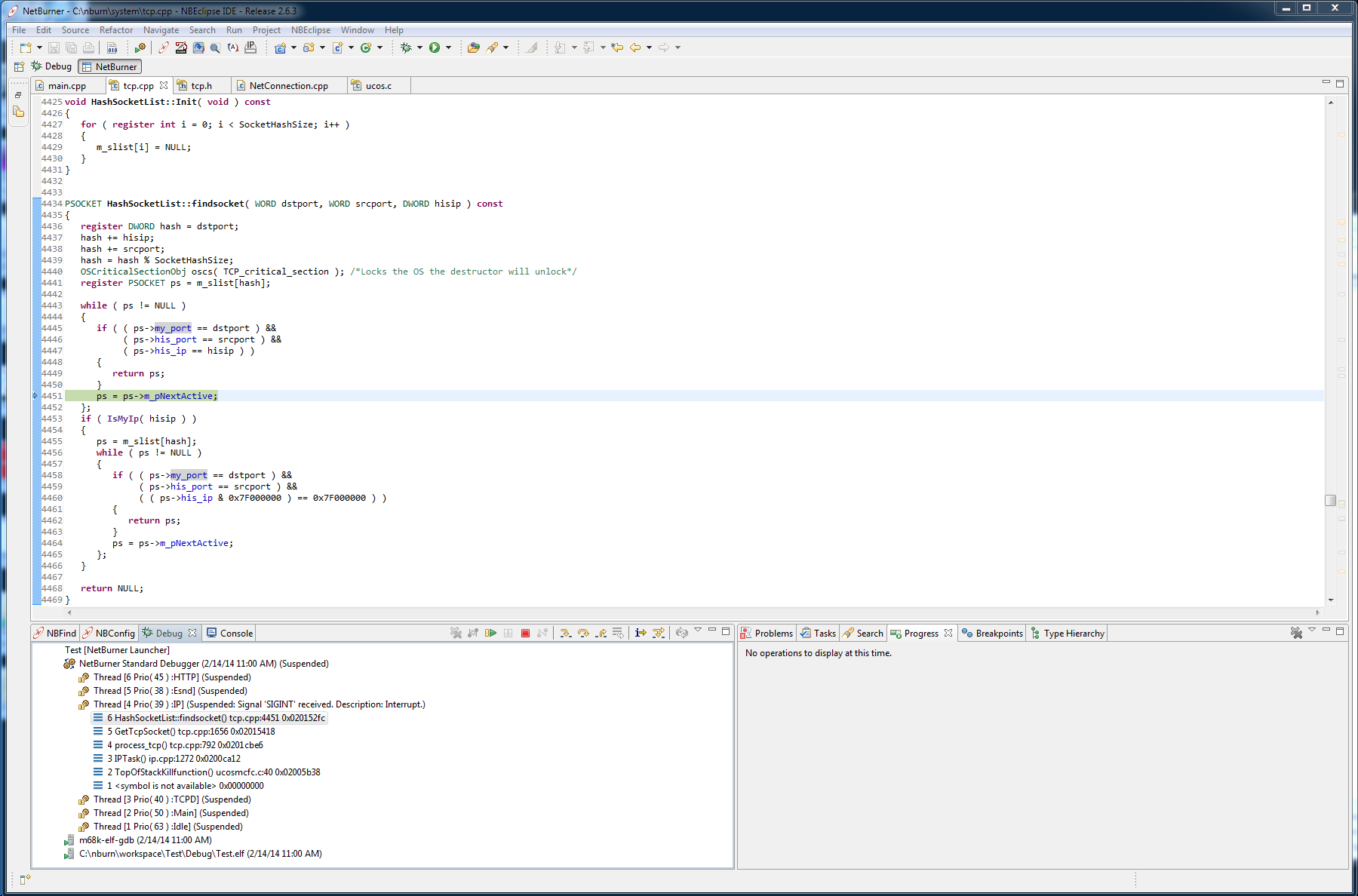

Repeated tcp connect success, and closures can cause an indefinite loop in the tcp.cpp connect process depending on the hash of the IP and port. The problem occurs when all of the TCP packets are used (I call them dirty), and they are never removed from the active list in order to be re-used.

Debugger paused, this is where it will loop indefinitely:
Debugger paused, this is where it will loop indefinitely.

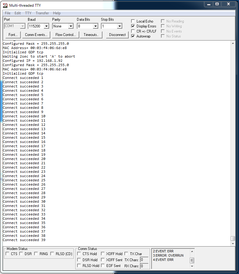

Example serial output (from a MOD5270):

The infinite loop comes into play because the socket isn't removed from the active list when abortsocket is called and the tcp state is TCP_SATE_CLOSED. If this causes a problem elsewhere please let me know, but it appears to have solved the issue on our boxes /w no apparent negative side effects (yet).

Thanks for the assistance. I updated it with your suggestion and it changed the output to Failed as expected instead of Success, so in that respect it is a closer solution since mine never addressed that problem.
However, it still doesn't resolve the infinite spin loop issue. The spin still occurs in the same location when ps->m_pNextActive always returns NULL. Any other suggestions? Thanks!
New output from the test application
Screen Shot 2014-02-14 at 2.35.21 PM.png (56.91 KiB) Viewed 11701 times
