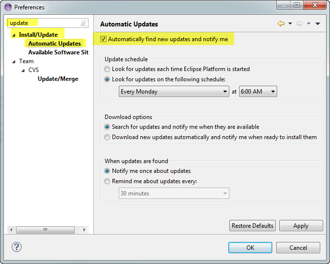

Also on staying up to date, I didn't cover it explicitly in part 1 (but thanks to you I'll get it in part 2 somewhere) there is a auto update setting. (I'm not sure which release of Eclipse this started in). Unfortunately this won't work with the NB plugins because they don't behave as normal plug-ins. I do understand why NBEclipse is a closed system. I'm not sure why the plugins themselves can't act like other plugins.
See the attached image.
Eclipse preference setting for auto updating
