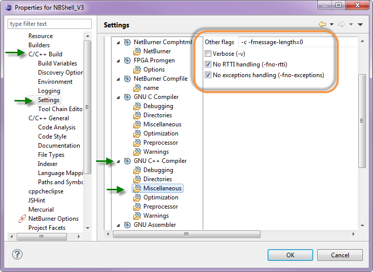

The resolution to the problem strikes me as somewhat strange. Eclipse does not (to the best of my knowledge) automatically turn on Exception handling. In fact, for this project under the project Properties->C/C++ Build->Settings->Gnu C++ Compiler-> Miscellaneous settings (see image) I have the checkbox enabled for No exceptions handling (-fno-exceptions).
My first course for Pluralsight looks like it's going to be an in depth tour of using Eclipse for C++ and Java. Maybe I'll entice Dan to switch over (you can still keep using MakeFiles in Eclipse).
Dan, if there's something in the code I could do that would have prevented this error (or at least made it more obvious what needed corrected) let me know.
C/C++ Misc. Settings
