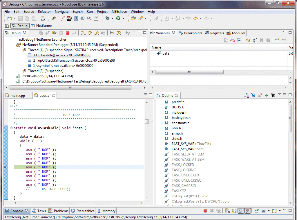

Setting a break point anywhere in my code still causes the debugger to stop in the OSTaskIdle function in ucos.c. I get this result in both Windows 7 x64 and Windows XP x32.
- TestDebug.gif (107.27 KiB) Viewed 19279 times
