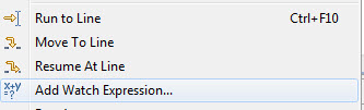

For some reason, it looks like Eclipse does not know that it is in the debug state as there is no Add Watch in the context menu when I right click on a variable. It used to be there.

You do have the Debug Perspective active right? In the version I just tested with (Indigo) when I right click on a source file I have an "Add Watch Expression..." and three other debug commands. What version of Eclipse are you using?
