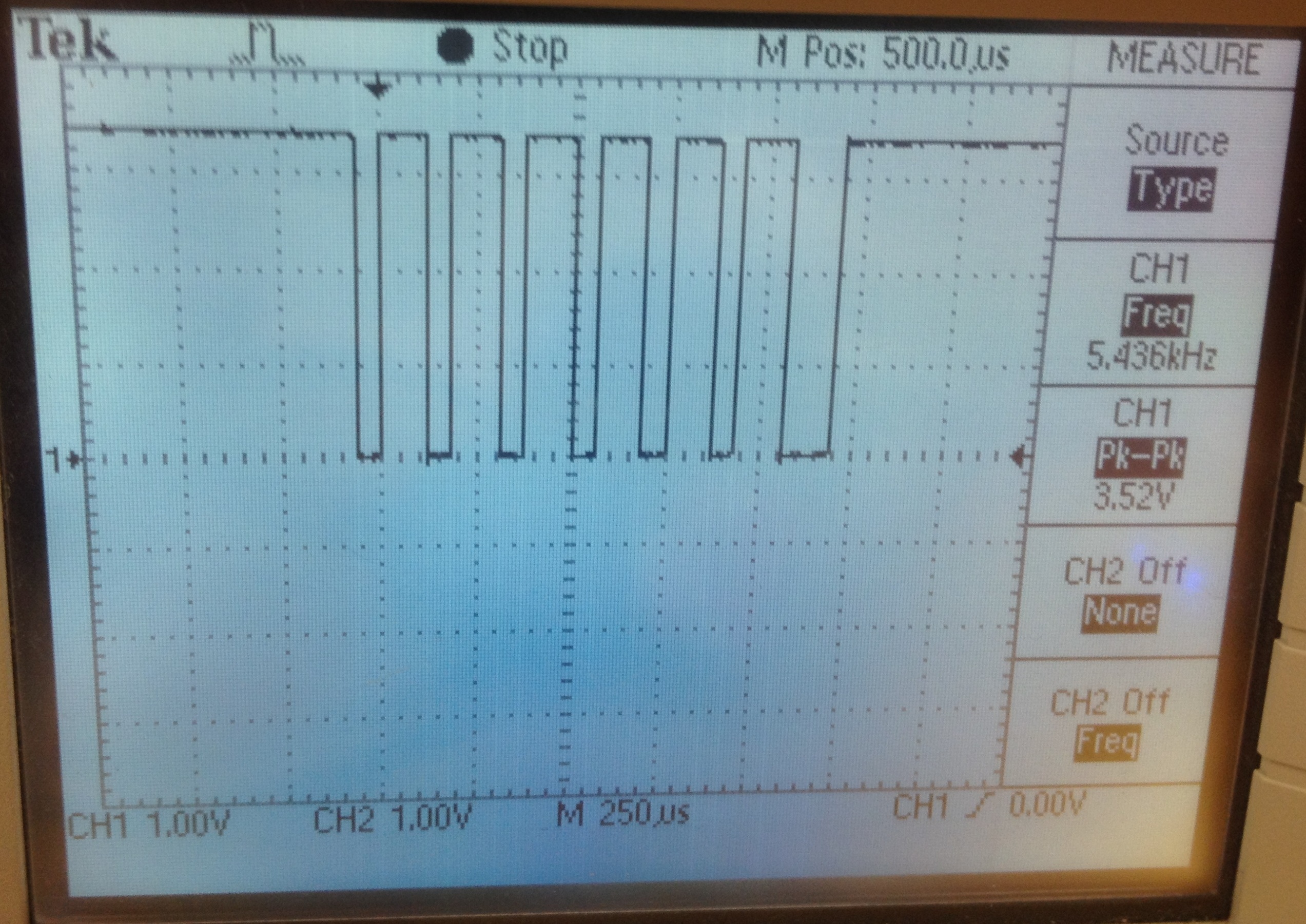

I am trying to set up the SPI communication between NB Mod 5213 and AD-5932 chip. However, there is something wrong that I couldn't figure it out. Basically I tried to send 6 word (each word is 16 bit) from Mod 5213 to the Ad-5932. CS pin idles high and drops to low when the data is being transmitted. However, I am reading 7 intervals of low instead of 6 intervals. I doubted that this may cause the failure of the communication with AD-5932. The figure attached shows the chip select pin during the writing.
