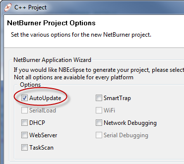

Another choice is to use the AppWiz project builder from within Eclipse. When you do, be sure to include the AutoUpdate code:
- AutoUpdate.png (28.88 KiB) Viewed 2947 times
