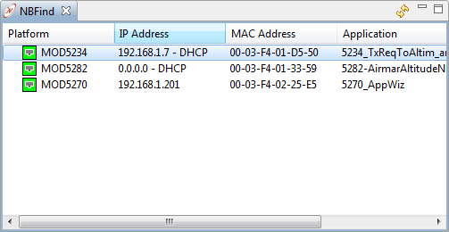

Two things to check: if your app name is longer than 64 chars, then NB Find can't find the NB and the next autoupdate will fail. Also, if you originally assigned an IP in your run configuration, then, maybe a day later, your DHCP server assigns a new IP, then the old run configuration IP needs to be editted. Can you see the NB using the NBFind tool. If you don's see this view:
[img]
[/img] then go to Windoe/Show/View/Other/NetBurner/NBFind
