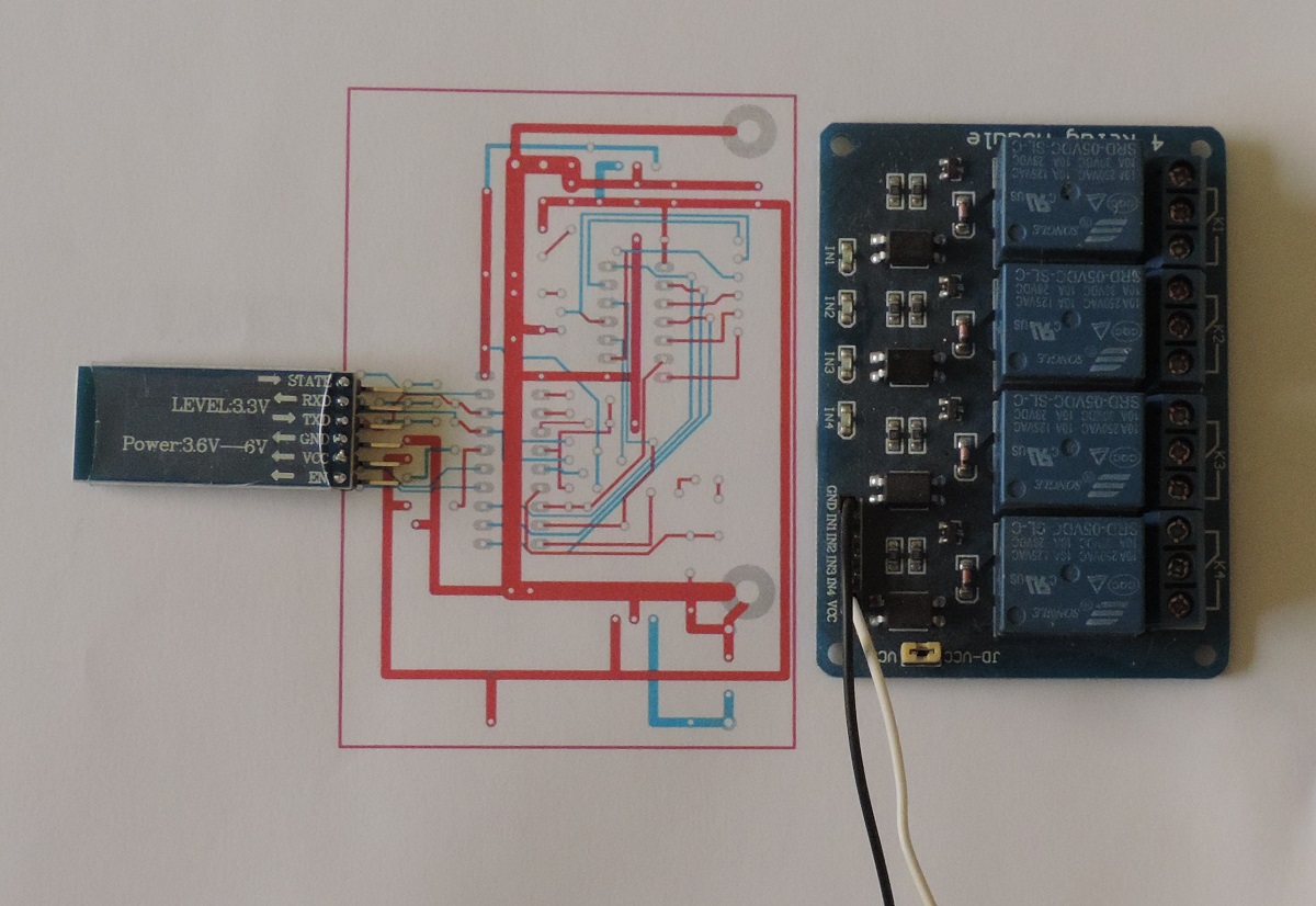

Extend the reach of your MOD5270 or similar with Bluetooth control of 4 relays, get data from one analog input channel, and have a few GPIO using the Texas Instruments MSP430G2553IN20. The master bluetooth will connect to a netburner and transmit to this unit to allow control of stuff in another room. Relay modules are about $5 on Ebay and the Bluetooth modules are about $2. Great range - connects up anywhere in the house.
