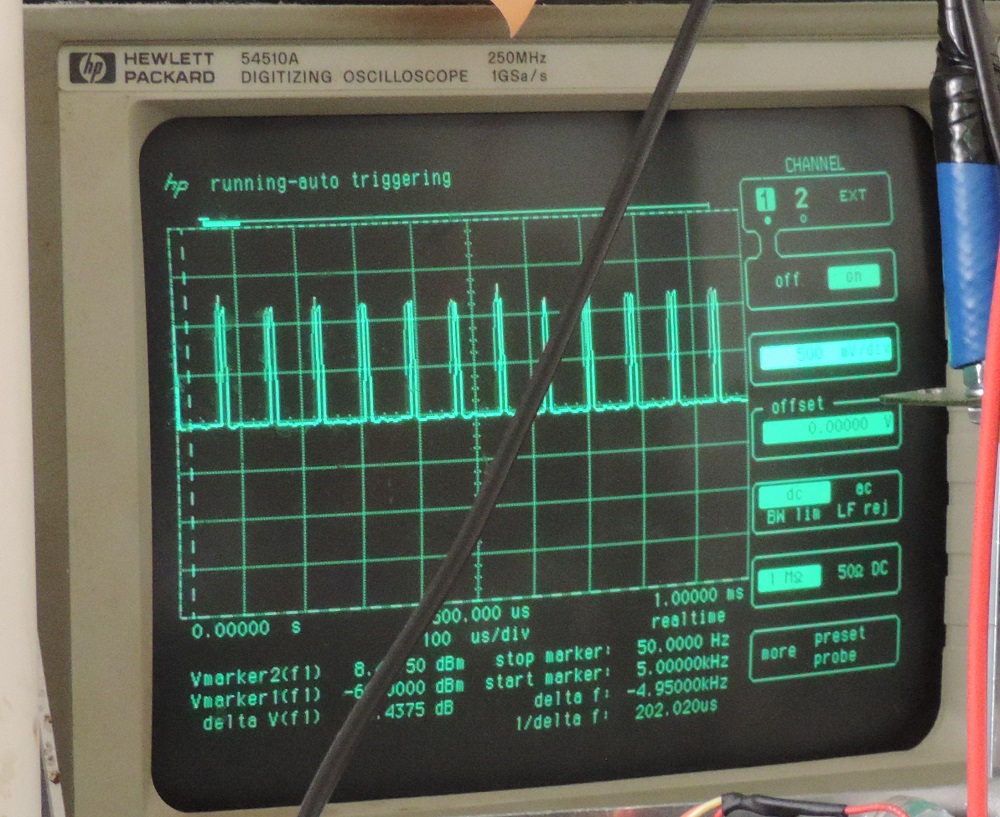

Mosfet gate drive - running at about 12.5 KHZ. It only takes that narrow on time to make 900V with the 10 MEG load of the Fluke! The frequency is set a bit low so it hits cycle current limit at about 1000V. Don't want to break any capacitors if something goes wrong. At 20KHZ you could get well over 1200V but I am using .1uf at 1000V as a filter on the other board. So I want 950 or so maximum.

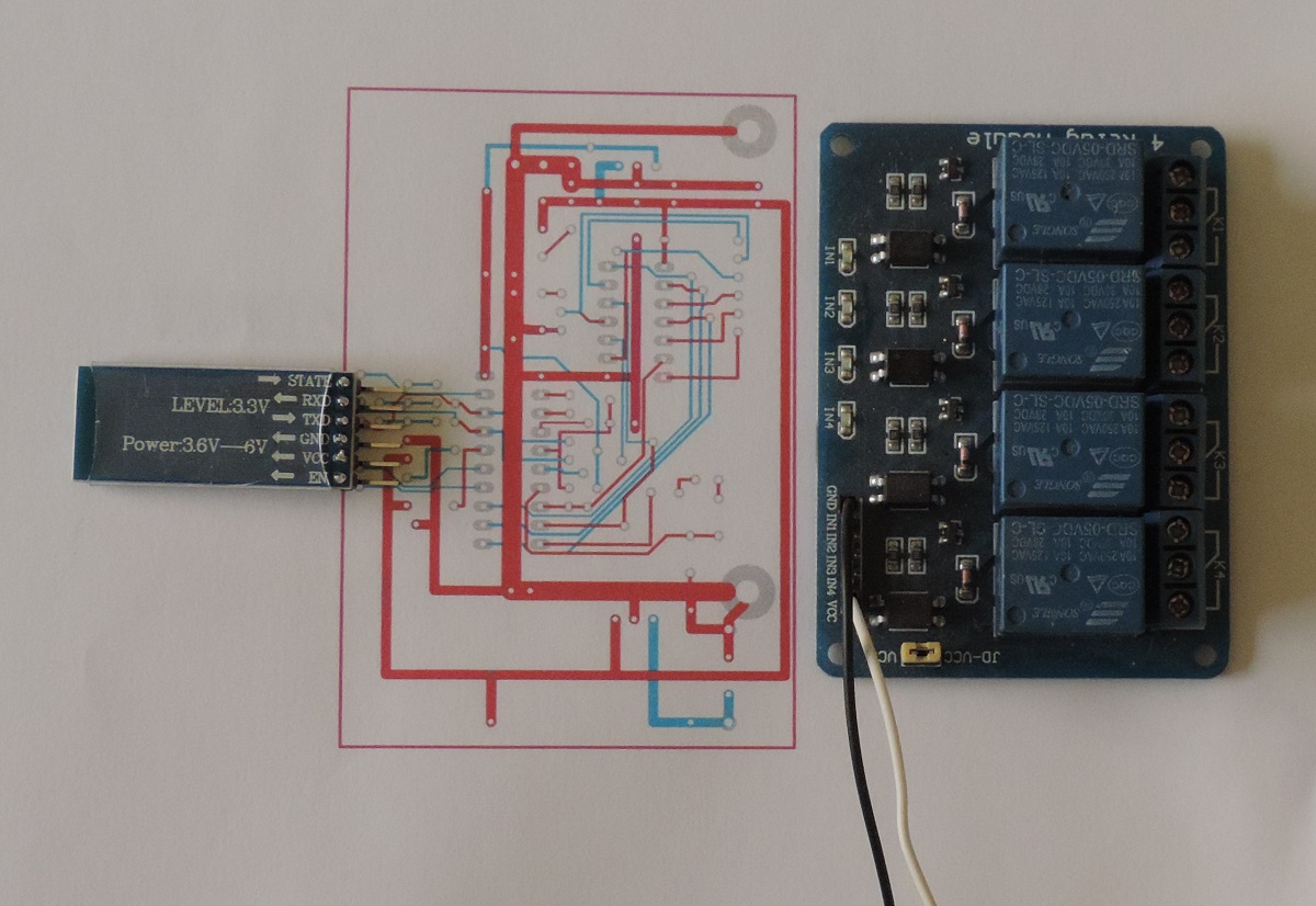

Extend the reach of your MOD5270 or similar with Bluetooth control of 4 relays, get data from one analog input channel, and have a few GPIO using the Texas Instruments MSP430G2553IN20. The master bluetooth will connect to a netburner and transmit to this unit to allow control of stuff in another room. Relay modules are about $5 on Ebay and the Bluetooth modules are about $2. Great range - connects up anywhere in the house.
