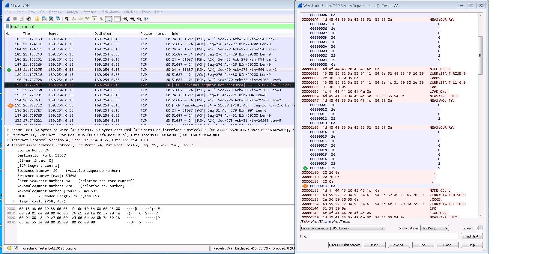

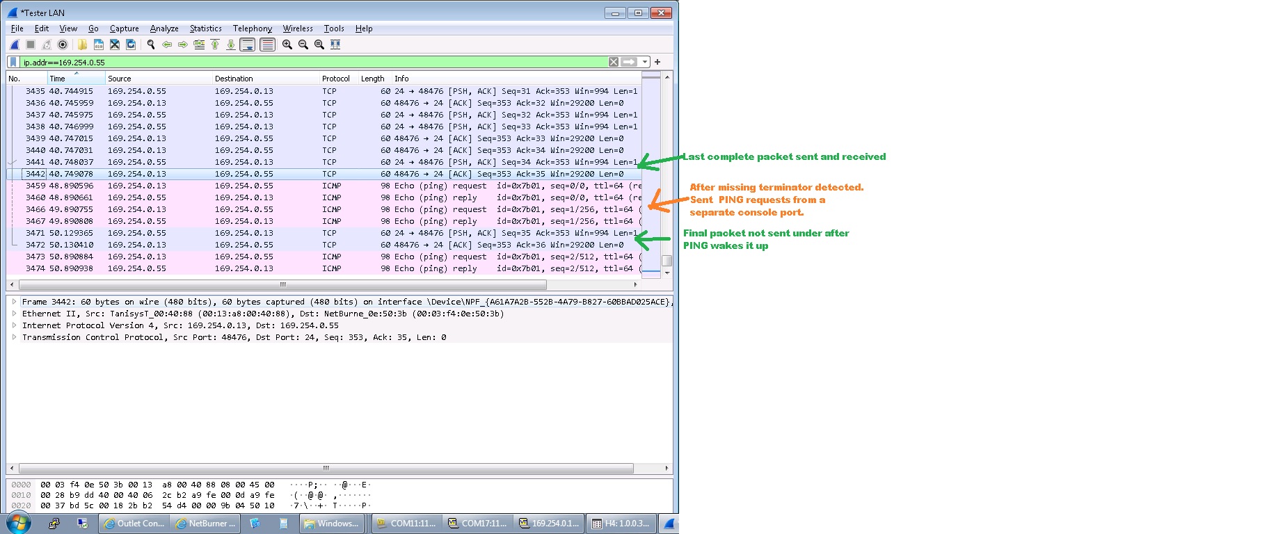

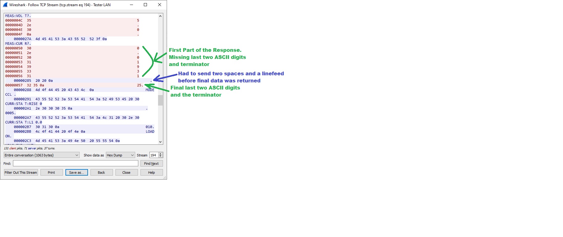

Attached is a WireShark capture of the issue. I also included screenshot of the TCP stream at the problem point. The Chroma Load Box is on Port 24. There is another Fluke 45 meter on Port 23 which will also appear in the capture. After a significant wait with no extra receive packets to provide the missing terminator, I send "0x20, 0x20, 0x0A" this is two spaces and a linefeed. That combination will be ignored by the Chroma itself to keep the Chroma in-sync with what my code is doing. After that combination was sent, the final three characters popped up on the receive side.
Sometimes, like this instance, only one set of "0x20, 0x20, 0x0A" is required. However, other times up to three sets must be sent before I get the final data and terminator back. Note: to see the extra bogus commands, you must view in HEX as all of the three characters are whitespace.
A correction to the previous post. Disconnecting the Ethernet cable will not always fix the issue. I had one instance where the problem remained. However, thus far, placing the SBL2e first in the boot order keeps the problem from occurring.

When running the SBL2e with the default setting that it ships with, it is sending back the data with only one byte per TCP packet. While very inefficient, that would not be an issue except that the SBL2e gets stuck sometimes at the end of the serial transmission and forgets the end the last couple of characters. Attached is a Wireshark capture that shows it. Also included is a screen shot of the WireShark decode of the problem area. In the screenshot, I placed a green diamond at the last good packet. The SBL2e sent it at 21.125275 and my end acknowledged it at 21.127316. At that point the SBL2e stopped sending data. My code waited several seconds and then sent three wake up "whitespace" messages. At the orange diamond, the SB2Le finally realizes that data remains and send it at 26.728712.
In this case only a single character remained, the linefeed terminator. In other cases, a couple of characters remained. In those cases, then final packet from the SBL2e will have all the remaining data and not individual bytes. The attached case is the simplest one. In the cases with more than one remaining characters, the SBL2e appears to send a packet out of order. My side sends back another ACK of the last good packet to signal what it is missing. The SBL2e ignores those duplicate ACKs and the data transmission stalls again until I send the wake up "whitespace".
This problem does not appear for me if the SBL2e is has the "Enable custom packetization logic" check box selected. If I select that option and leave everything else the defaults, then it sends multiple bytes per packet and the problem was not seen on an extended overnight run. In the User Manual, there is no documentation of the operation when this check box is in it default, un-checked state. For any others, with intermittent data problems on the SBL2e, I would recommend enabling those boxes, even if you want what appears to be the default settings.

I changed my code to pause for 60 seconds after detecting a missing terminator instead of sending the whitespace wake up TCP commands. Once I saw the printout that it was in this 60 second wait portion, then I sent ping requests from a separate console window. These pings were coming from a entirely separate OS instance. The original TCP connection was still open and still waiting. Attached is a screen shot of the WireShark. You can see the last packet was successful and then the SBL2e just sat there until the pings arrived eight seconds later. After the PINGs woke it up, then it sent the final packet back to the original TCP connection.
- WireSharkTCP_Stream3.jpg (324.33 KiB) Viewed 38190 times
