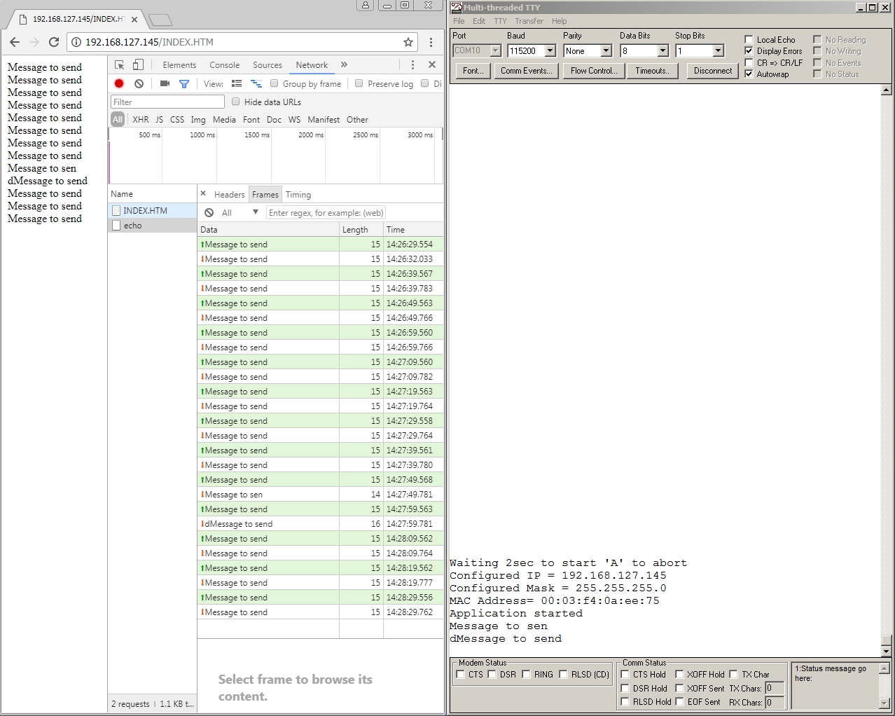

Re: WebSocket receiving mangled messages
Ok, so here're the code and the screenshot of output:

- websocketecho.jpg (454.69 KiB) Viewed 7811 times
The message is being split and delayed by the browser/OS....
So my question for you is:
What browser?
What Browser version?
What OS?
What OS version?
Do you have any browser debugging windows open?
What hapens if you use a differnt browser?
Since its a browser bug, I'm not really sure how to fix this....
Results were achieved on 64-bit Windows 7 Professional SP1 in Google Chrome 63.0.3239.84.
Firefox 57.0.2 and IE 11.0.9600.17843 hangs after sending and receiving first message (Netburner reports that socket is closed).
Browser debugging tools seems to not influence on situation.
