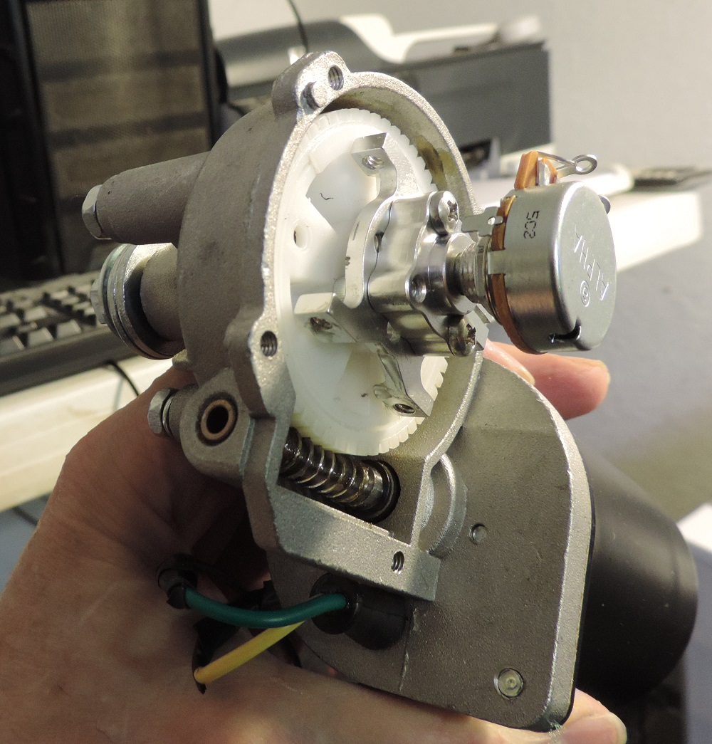

Got the parts for the potentiometer mount for wiper servo prototype #2. Much neater and much cheaper than the local machine shop fabrication and I wish I had thought of this before I wasted a week waiting for the machine shop. The Actobotics channel mount just happens to press fit on the nylon hub. I drilled the nylon hub and use two self tapping 6-32 screws to hold everything on. In addition the clamp hub is mounted to the bracket with two allen screws from the back. Since the potentiometer takes very little torque to drive - this will work great. All I need now are the two aluminum plates. That will take about another week.

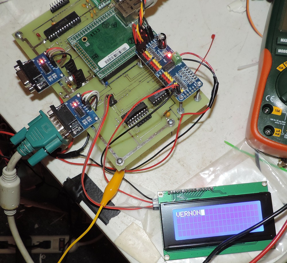

This, getting my name on this display, was a real pain in the ass. I bought an Arduino 4 x 20 iic display because the price was great, about $5, and figured it would be simple. Found that there is no documentation. The idea is you connect it to your Arduino, down load the sketch, and write your text using their functions. Luckily the number on the chip on the I2C board was readable so I got the data sheet for that, it is an 8 bit port expander, and I also got the data sheet for the Hitachi HD44780 controller display. I got the port expander working and toggled one bit at a time to figure out where they went on the display. I then had to initialize the display in 4 bit mode because that is how it is wired. I had to do everything as if it was a parallel display and then wrote a function to display a character string. I had thought it might come up with a flashing cursor waiting for an ASCII input - but no joy. There is no intelligence in the adapter. Each character has to be split into two nibbles and written in two steps. The whole thing took about 10 hours.
Normally I would not put a local display on something that produced a web page (I would just look at the Kindle) but I figured that there could be an application and the display was super cheap. Really great for $5.

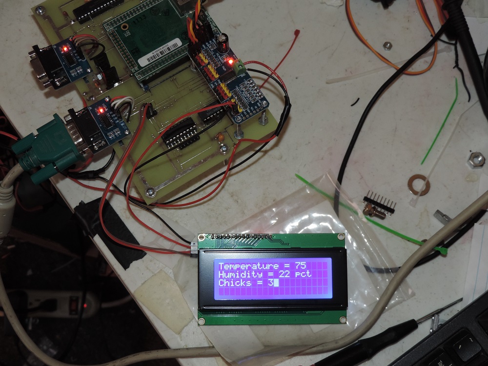

Got the display totally dialed in! I even thought of a reason to have a display on a Netburner. Your website would telnet in with the forecast and any chicks who wanted to do you that day would log in. So you wake up to the temperature, humidity and the available chicks right on your nightstand! On a given day what could be more important than whether you are going to get laid or not? You could even have an algorithm to sort the chicks - a hot one you hadn't done yet would get a high score as would a high performance babe you hadn't seen in a while. Same old, same old would get a lower rating and the pick would appear in the bottom line. The code using my functions is below - I have full C formatting and it is simple to use! Variables don't make sense because I just used some for this test that were unused.
loopcount = 75;
sprintf(displaybuffer, "Temperature = %d", loopcount);
ShoDisplay ();
// ClearDisplay (); sets cursor top left and clears text.
speed = 22;
sprintf(displaybuffer, "Humidity = %d pct", speed);
SetCursor( 40 ); // second line
ShoDisplay ();
packcount = 3;
SetCursor( 20 ); // third line
sprintf(displaybuffer, "Chicks = %d", packcount);
ShoDisplay ();
loopcount = 75;
ShoDisplay ();
speed = 22;
ShoDisplay ();
packcount = 3;
ShoDisplay ();
