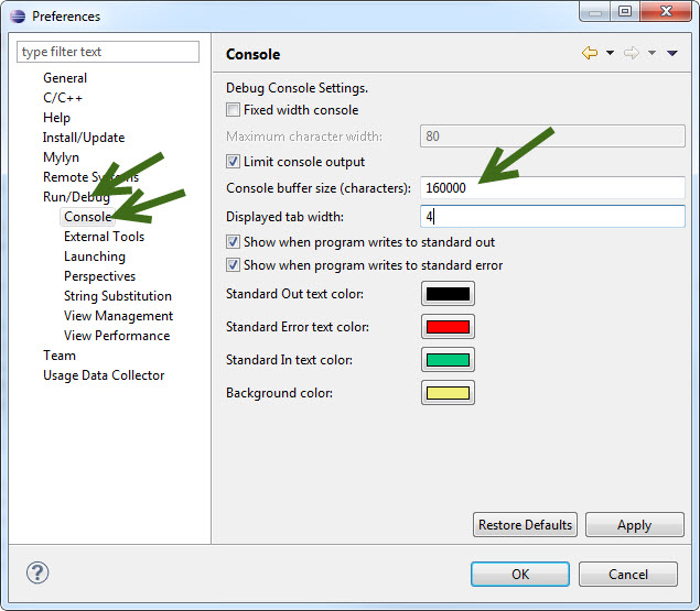

You can increase the size of the console output buffer. Window->Preferences then follow the arrows in the image below. Generally though you want to lint one file at a time. You also want to start with the low-level files you've written that don't include too many other files. Then work your way up. This should limit your errors. You can also supress library errors (-wlib(0) - but Gimpel recommends against doing this). Once you have all your individual files clean (or you've suppressed the errors that cause the bulk of the noise), you can try linting the entire project.
