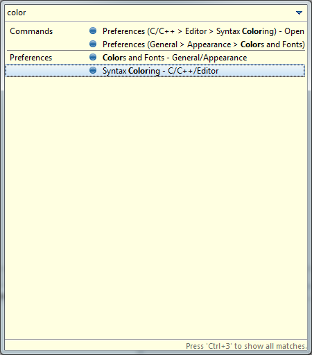

Use Quick Access (the default keystroke is Ctrl-3) and type color. In the list you'll see the preference setting for C++ syntax coloring (see image). Use this to see if you can get what you're after. (You'll also notice there are other coloring options).

I am not sure this has what I want to do. I understand that I can change the syntax coloring, but basically, I want to be able to highlight a section of code and give it a different style/color. This way I can make say lines 50-200 have a yellow background and lines 200-400 have a blue background.
I don't think I can do this through preferences since the adjustments made always apply to the entire document.
