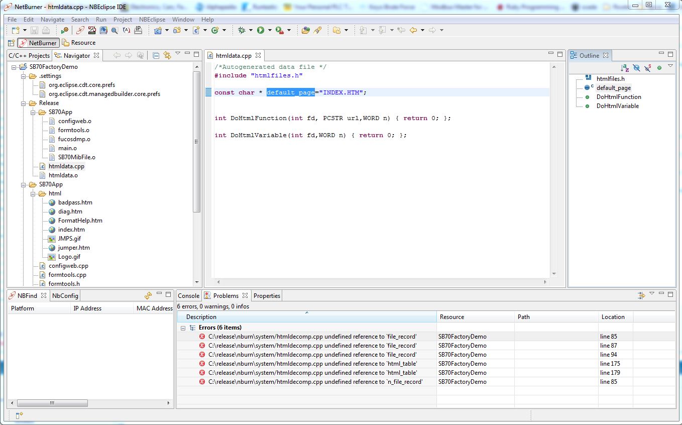

I'm following the instructions in the NBEclipsGettingStarted.pdf to start a new project and import an example. In my case I import the SB70 example. So far so good but when the import is ready it start compiling and building automatically. However the build is stopped due to errors. At build a directory can't be opend: Cannot open directory: [..\html] when reading files from ..\html and compressing them into htmldata.cpp.
I have admin rights but it looks like the builder can't access the directory.
Does anybody have an idea of seen this before and solved this? I searched the forum on topic "Cannot open directory" but the items were too common.

C:\Nburn\lib\NetBurner.a(htmldecomp.o): In function `SendHtml(int, char*, int, char const*)':
C:\release\nburn\system/htmldecomp.cpp:175: undefined reference to `html_table'
C:\release\nburn\system/htmldecomp.cpp:179: undefined reference to `html_table'
C:\Nburn\lib\NetBurner.a(htmldecomp.o): In function `GetRecordFromName(char*)':
C:\release\nburn\system/htmldecomp.cpp:87: undefined reference to `file_record'
C:\release\nburn\system/htmldecomp.cpp:85: undefined reference to `n_file_record'
C:\release\nburn\system/htmldecomp.cpp:94: undefined reference to `file_record'
C:\release\nburn\system/htmldecomp.cpp:85: undefined reference to `file_record'
collect2: ld returned 1 exit status
Build error occured, build is stopped

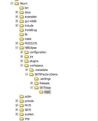

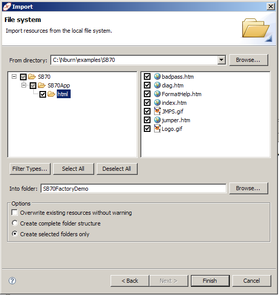

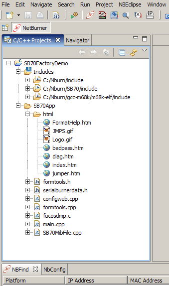

Thanks you for spending time on this problem. I'm working with an old Netwburner SB70 SDK Rel22_rc2 on a Windows 7 64-bits machine. I have some problems with this SDK. To check if the problem is the Window 7 64-bit machine I took my old Windows XP-SP3 32-bits machine as user Administrator and do the same thing as on the Window 7 machine. So far I can tell that this XP machine does have the same behaviour. That means that or the SDK has a problem or I am consistent in making the same error. I hope I'm the problem! :)
I used the AppWizard and saw that there is a HTML directory made in the App directory. That is what I also see when I import the example App SB70 from the example directory.
I have made some screen caps on the XP machine and are as follow. As far as I can see the HTML directory is present.
Any idea?
the import view
the import view
the project view
the project view
The winexplorer view

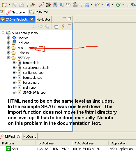

Gotcha. When you import the sb70 example the html directory is placed in SB70App. One level too deep. The Appwizard did it! It showed it had to move one level up.
Thank you rnixon.
