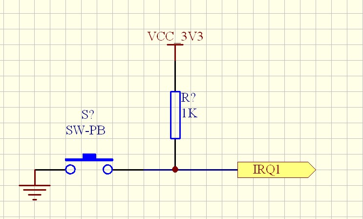

[img]C:\Documents%20and%20Settings\HICOM\桌面[/img]
The schematic IRQ1_test is my test circuit for IRQ1 level-sensitive triggering.
and I set "sim.eport.eppar= 0x0000;"//set the IRQ1 level-sensitive.
The interrupt routine is triggered by the state of the IRQ pin, and executed immediately. If it is level-sensitive, it will be executed repeatedly while the IRQ pin is low. However,when I release the button
(IRQ1 pin is high),the interruput routine executed forever.
- IRQ1_test.jpg (56.27 KiB) Viewed 8782 times
Re: IRQ1 low-level trigger
The issue you have is to do with key bounce. The switch you are using is most likely generating contact bounce for approx 10-20ms after you press or release it.
This will cause the interrupt to re-trigger if you don't have a way to ignore them.
To handle this you will need to use a timer to ignore any interrupts within this time period or if you can, use a key debounce IC with your switch.
